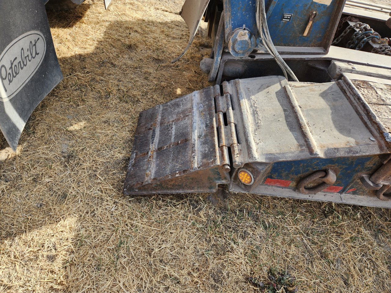

    I'll try to remember to get a picture ot the ramps on my Aspen tomorrow. They have held up very well.

    Here you go:
    I've had this trailer since 2009, and it is a 96 model. I've hauled D8s, our 945, and about anything else. I've never had to do a thing to them.

    Yes I see where they could get in trouble especially if they are just a little off center when they load.
    I just wondered about the sag because I am repairing an older trailer that has a permanent sag and probably had about 4 inches with a 55000 pound machine on it.

    Mine is a 94 and was pretty much like that when I got it around 2018
    Looks like yours has done really well
    I like that flat bottom design so it won’t sink as bad on soft ground or oil and chip roads
    That hinge looks light but obviously it’s holding up better than mine
    Do you load much on crowned roads…that seems to be how mine get twisted to the point they won’t fold

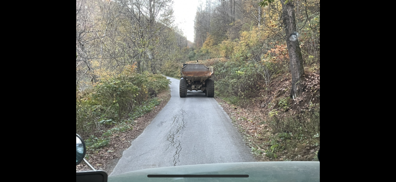

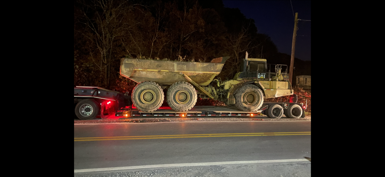

    Picked this one up in Panther, WV. Had to drive it about 1 1/2 miles to get it to a place to load it.
    I’m allowed 104K here in WV on 5 axles. It had me at well over 100K, it was low but handled it fine…..

    Occasionally, but mostly off road. The double hinge seems to allow a bit of flexibility as well.
