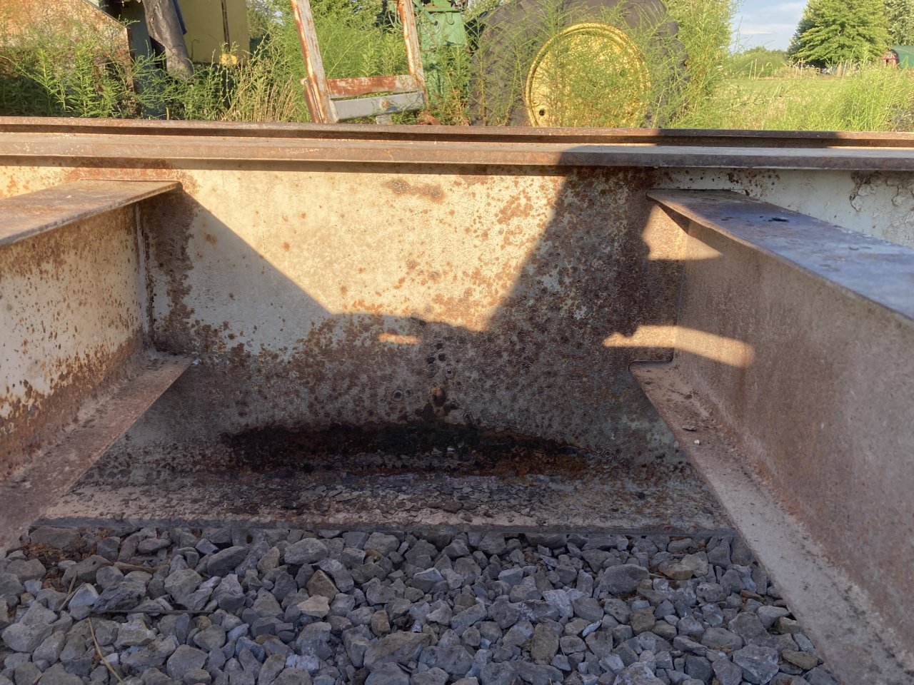

    This one was a little beyond that

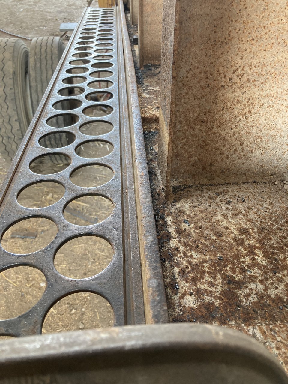

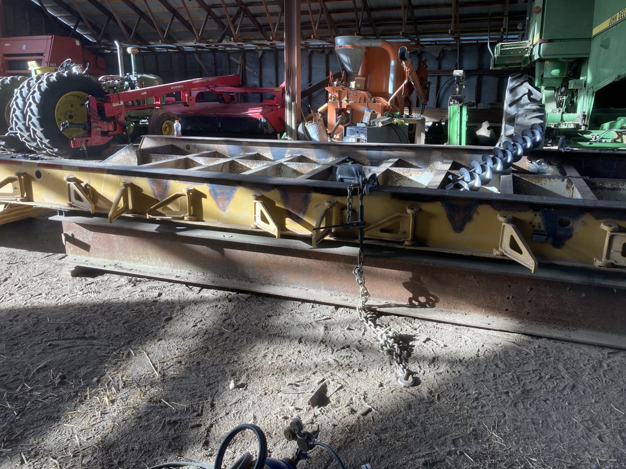

    most of the main beams look like this on the bottom 5C468152-87CC-4488-A092-961A5F7D7F47.jpeg

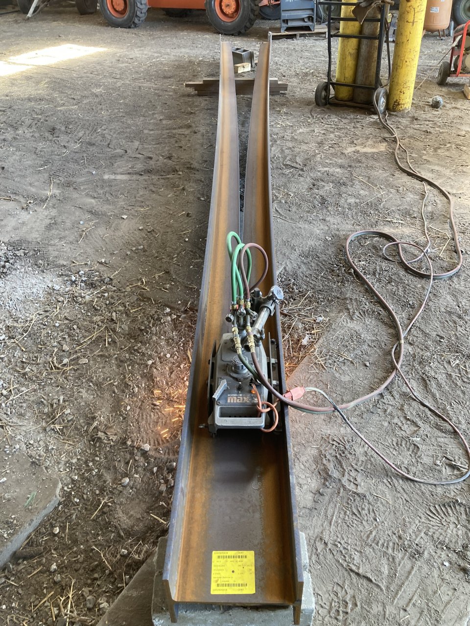

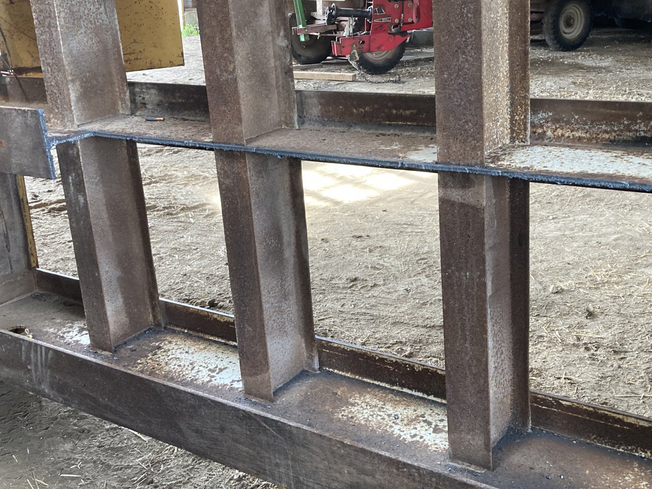

    Cutting a new beam in half to replace the rusted part of the beams 8F246305-06F8-43F4-8312-C4A409A5255F.jpeg
    Working on cutting away the bottom of the beams below the cross members A4903F88-5F34-4E06-9247-D6DCD75B7D5C.jpeg
    Removing 1-1.5 inches of belly and putting about that much camber in 646FC852-F0AD-4AE4-B0B6-E9BBEE89A8EB.jpeg
    Had a little kink in the beams behind the neck…apears to have partially broken there at some point
    Thankfully this trailer is built from common w beam and not fabricated beams like modern trailers

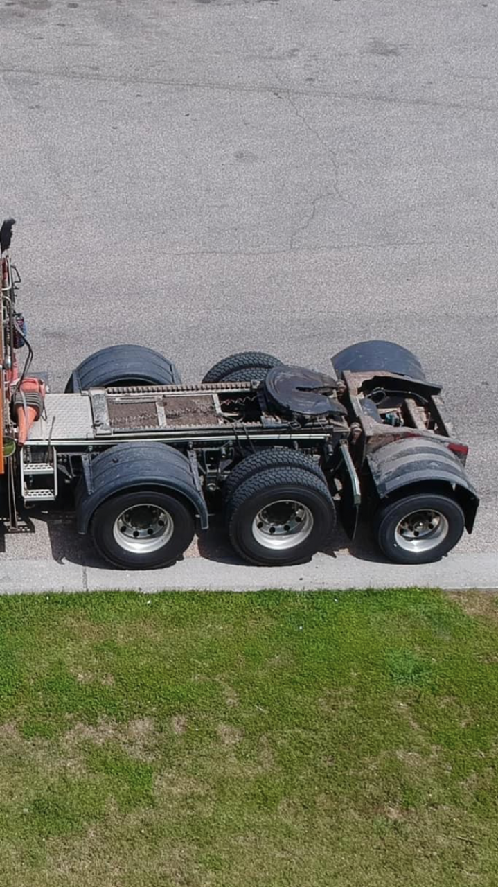

    We generally only do five axle freight. We have one for axle truck and 4 55 ton Fontaine rgn’s. Sometimes they will hook one of the 55 Tons behind a regular tandem truck and just load all the way to the back for a somewhat local move up in Washington.
    There is a handful of us drivers that have the skill set and want-to to move on to some of the heavier freight. We just don’t have the equipment to do it.
    that being said our four axle slip seat truck is eight years old and only has 160,000 miles on it. So we don’t really need a bunch of four axle trucks. That’s why I think a single axle jeep pared with a tall neck trailer would be a good fit. You can hook up to it with a tandem Tractor, go do the load, bring it all back to the yard drop the jeep and trailer together and you’re back to hauling regular five axle freight.
    Setting up a few tractors for a pin on fourth axle is another option. Problem with that is I haven’t seen a set up you could pull a mechanical rgn’s with. Seems like all the mounting ears get in the way.

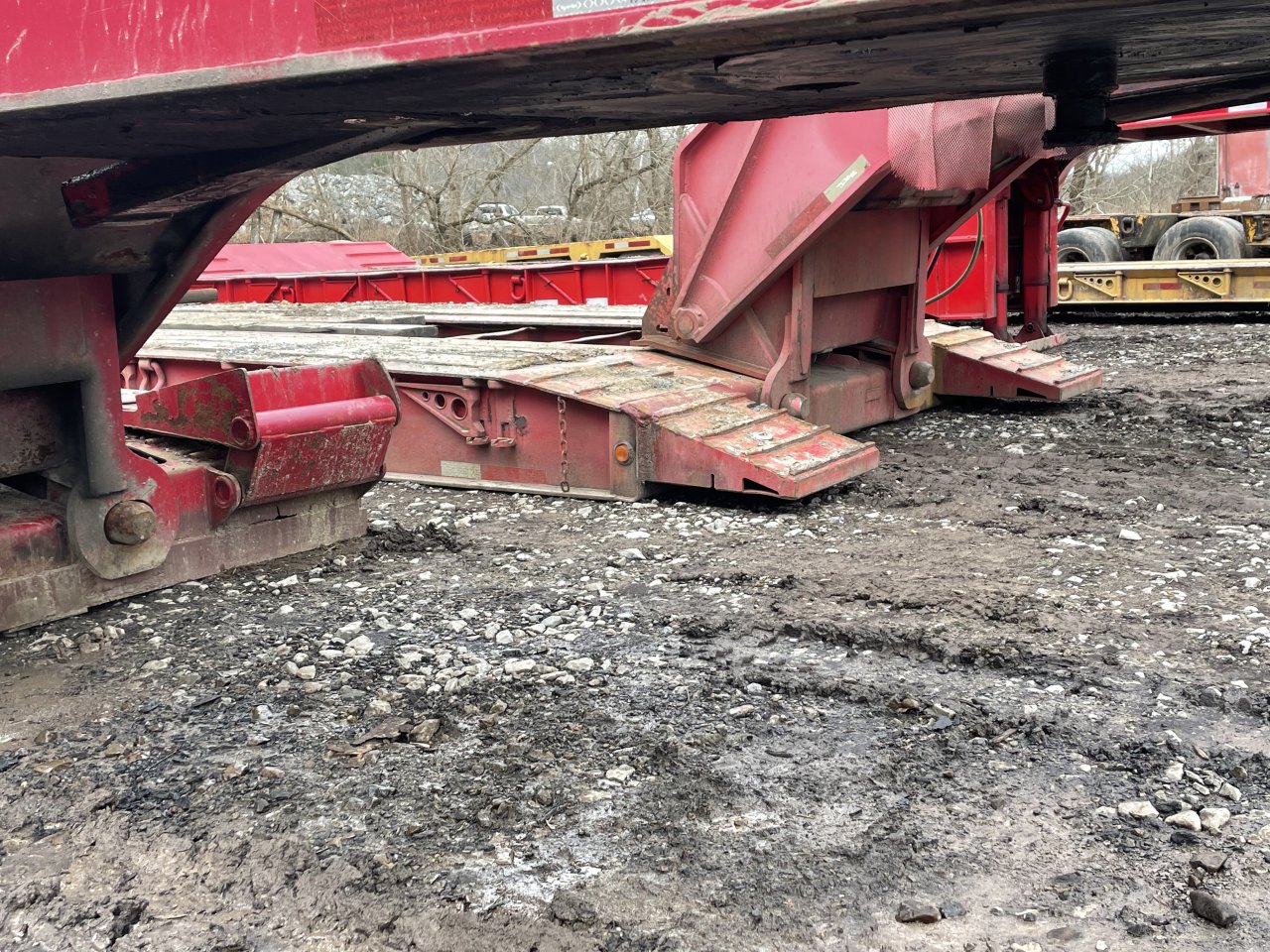

    Was at a auction yesterday and happened to think about this post on ramps…..
    1F62369F-33DD-4DC8-9E19-DBA347A77B87.jpeg 1B109BC4-46EE-4DBD-8B26-D85F1F559C08.jpeg
