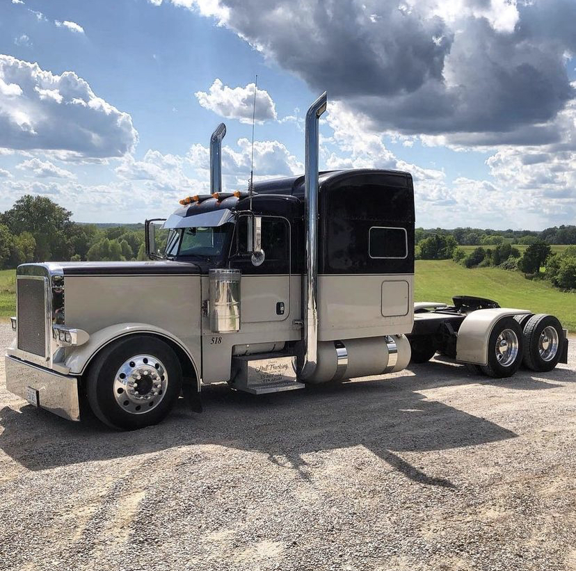

    MY 2013, 388 Had a 6mm block in it and it sat up like a 4x4 dump truck lol I went to peterbilt and they had a .05mm block or basically a wedge and I had u bolts made locally cost me total with alignment $520.00 lowered front end 5.5 inches and had to adjust the rear bags a little to compensate the drive angle but has worked fine for a couple years now

    but for those of you looking for the car hauler front axle for the 379 it is a meritor part # ff943 or peterbilt part # 02-02969 that's what I have in my 2004 379 car hauler
