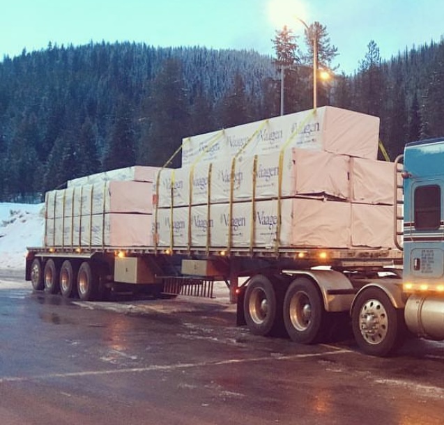

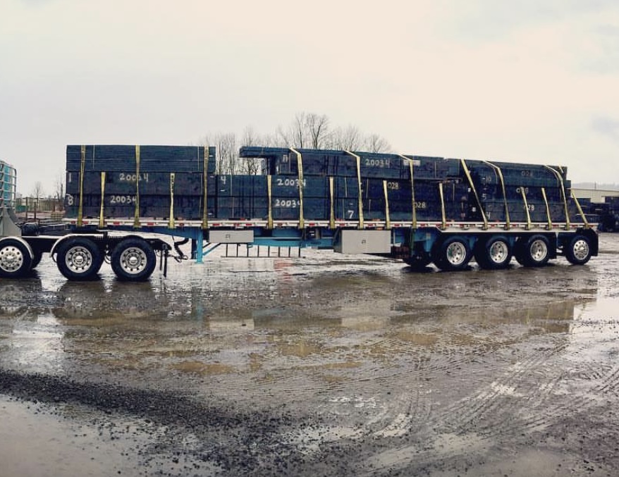

  7. Long FLD
    Long FLD Road Train Member
    12,959
    54,394
    Mar 4, 2015
    More weight. My experience running the NW and Western Canada was that they tend to watch and enforce securement more than they appear to in other areas of the country. I still can’t get used to seeing trucks loaded 3 or more units high with all their straps over the top running around out east.
    81879BEC-467D-49DE-8F36-E410B31D75A6.jpeg 8A34F714-AB4B-46EA-B652-806CCDABDAB0.jpeg
  8. Diesel Dave
    9,751
    33,483
    Jan 20, 2010
    Hesperia, Ca.
    Wasn’t like that before. You can have 3 tiers high, no belly wraps required. Now depends what jurisdiction your in(depends how savvy the cop is). Green lumber is a piece of cake to strap, dryer lumber has is lighter so you get more volume(more units) more securements.
  9. Long FLD
    12,959
    54,394
    Mar 4, 2015
    Technically it’s straps over 2 units or 6ft, whichever is more. But most who haul maxi loads will strap the bottom 2 no matter what just to make the load more stable.
