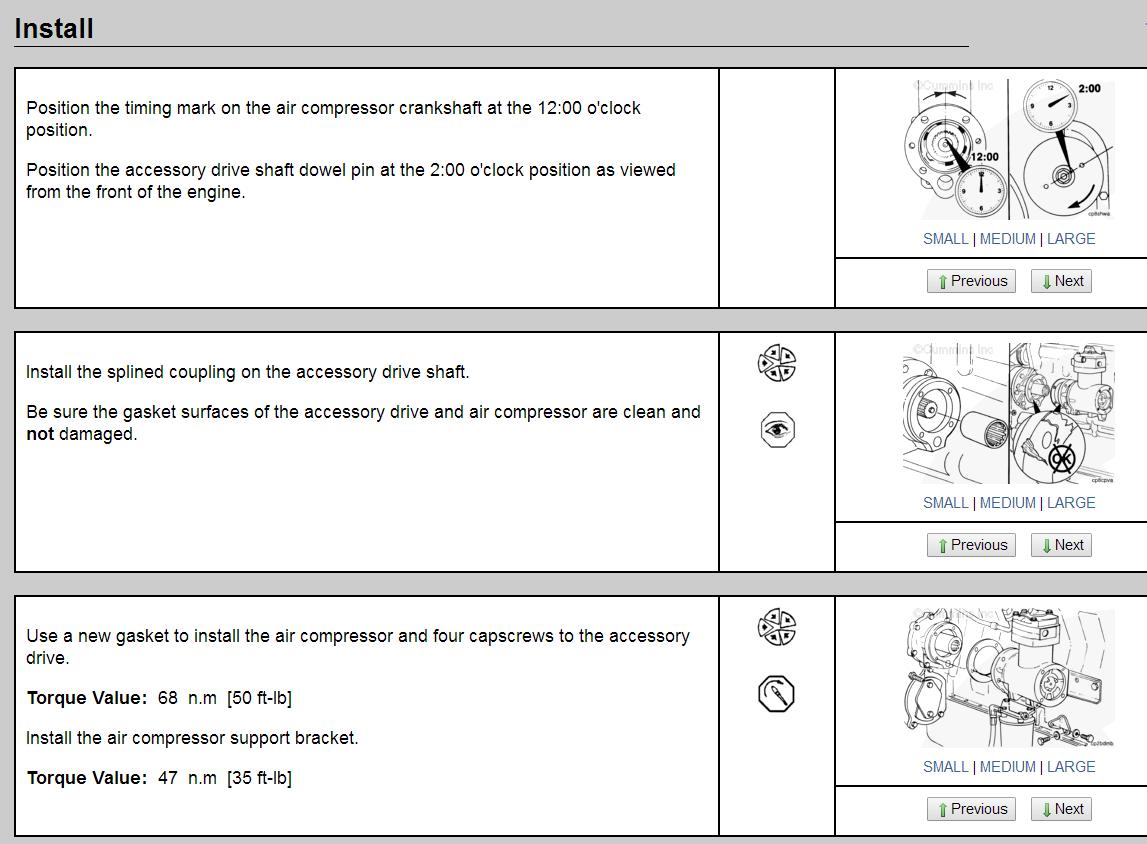

    Ok guys picked up a compressor for my truck today.. I've heard some people say you have to time something fuel or pump not sure but would like to know is this a straight forward swap or I need to put it in the shop and have it done..thanks for the help ..
    Oh 1997 m11 select plus

    air compressor.jpg Air compressor must be timed to the engine, fuel pump doesn't matter.
