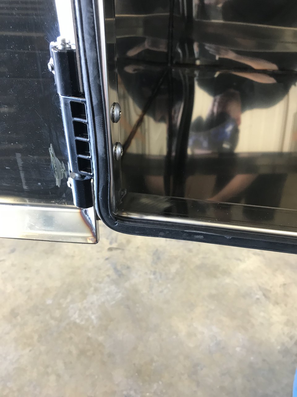

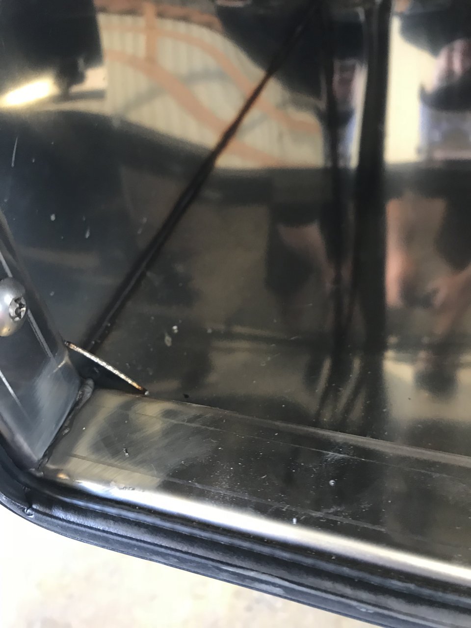

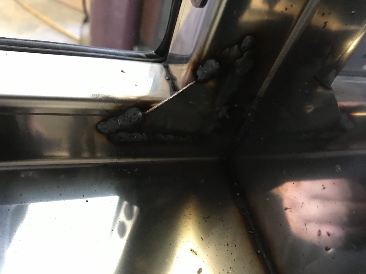

    You may want to reinforce the corners before you instal them boxes. The corners are just but welded. Every one I see including the first one I bought is cracked .
    They are all fixed now I hope?
    Before
    9842C719-5E2C-41BE-9BA0-F18D1394A761.jpeg After
    E0E430BE-3B5B-4077-AA90-2AFC897F811A.jpeg 78294DAF-6B0E-476D-AB33-E10B7F863894.jpeg
    snowman_w900 and Ruthless Thank this.

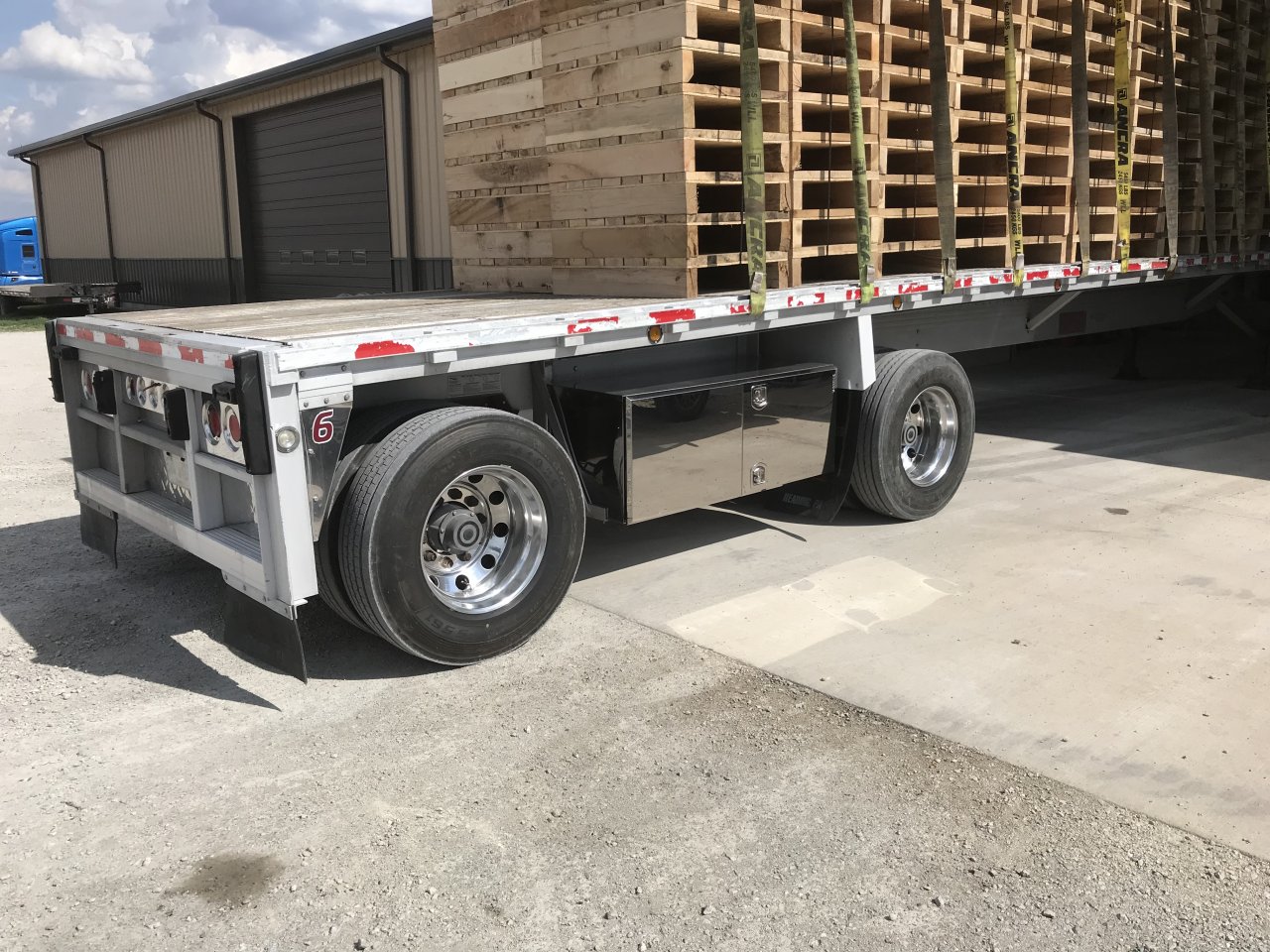

    The first one I bought last year is on top of my headache rack. 43177664-BFD4-4887-9AD5-22C320737AF0.jpeg i put a piece of good 3/4 plywood in the bottom bolted to box and brackets to distribute the load across the whole box. They are very thin. 9B539EEB-E3E9-4406-B843-0F3B2299E11D.jpeg the second is in between the rears on the original aluminum L brackets. I used a little rubber strip in between the box and bracket (for corrosion). CC6BDA0E-6D28-490B-9F3C-B5C91D7C71EB.jpeg
    I just picked up my 3rd yesterday (on order for 2 months) I will install it on between the wheels on the other side of the trailer. It will house my generator.
