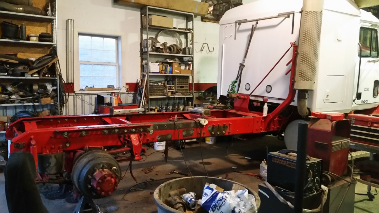

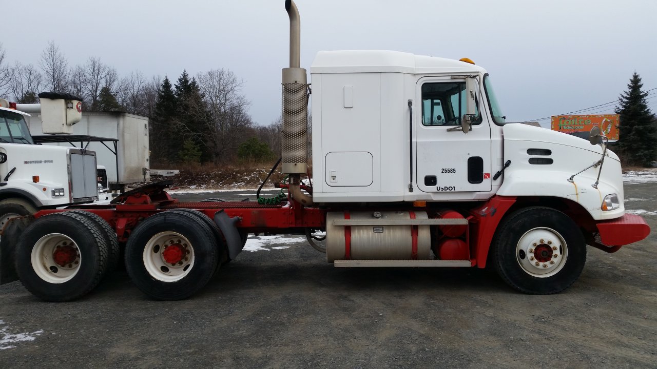

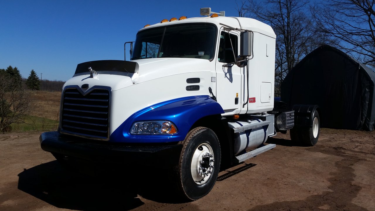

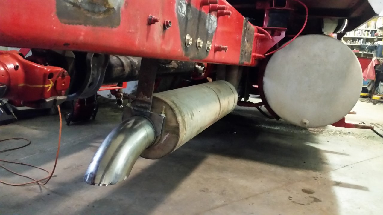

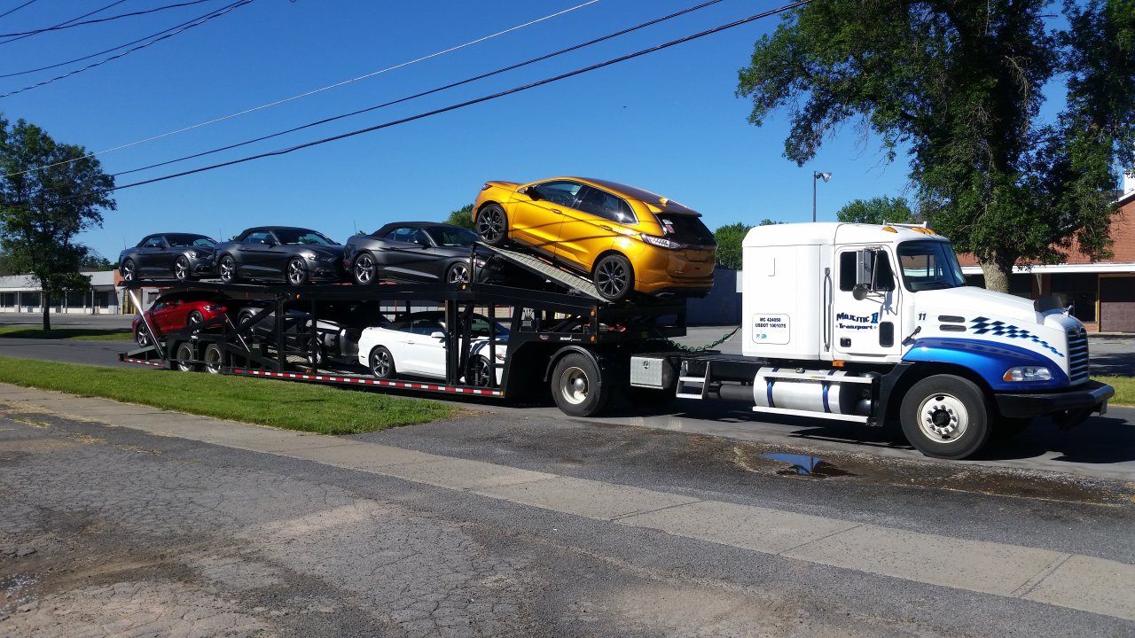

    I got a real good deal on a 2000 CH 613 that needed a lot of TLC. Was looking for a single axle to pull a 7 car trailer so I made some major modifications.

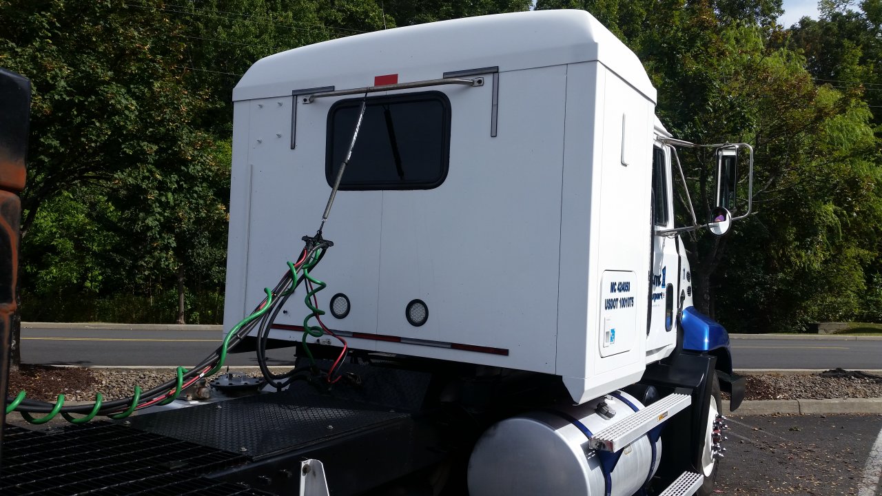

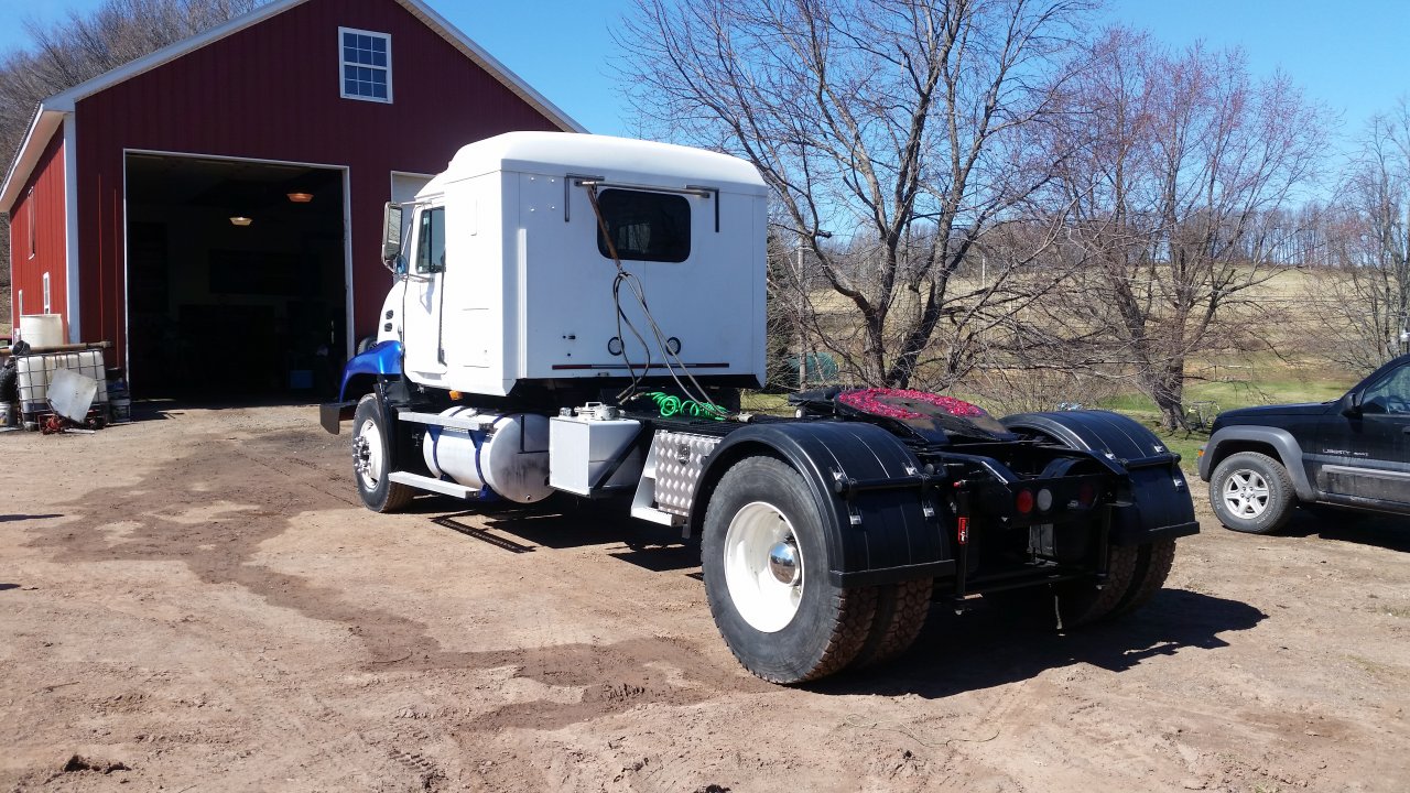

    As you can see from these pics she started out as a single stack Mack with a small shack on the back. In the end the exhaust was converted ta weed burner (more turn clearance with a short wheel base for the front over hang car), rear window in the sleeper (I did a lot of blind side backing in car dealerships) and slide the front differential back to single it out (saved a bunch of tolls running the NY Thruway daily).
    The window was a fairly easy modification using a window kit from a RV dealer. Only thing I would have done differently was use a larger window that opened so that on the nice days when I wasn't idling I could have had more fresh air in the bunk. The exhaust and axle mods required some fabrication but it was more time consuming than hard to do.
    Engine mods and such are not very common probably because there just are not as many Macks on the road as the other brands, at least that would be my guess. You may have to make your own special parts if you want to modify your 613.

    Air suspension for the front axle should be easy enough, maybe find a air ride suspension from a salvaged truck and make it fit. I am not aware of any conversion kits on the market.
    The rear wall of the Mack is built just like the side wall of an RV, didn't need any spacers or anything. Used some square tube, think it was 1/2", to build the frame that the window screwed into. Made a nice wood trim ring for the interior because I didn't like the trim ring that came with the window kit. About a day to install the window.

    Nice! Was that an ex Weatherford truck?
  8. brian991219
    brian991219 Road Train Member
    2,778
    5,350
    Aug 10, 2013
    Lords Valley, PA
    Yes, good eye

    Maybe I’m wrong, isn’t this a vision? Or a CX? Doesn’t look like the CH613’s i was familiar with.
