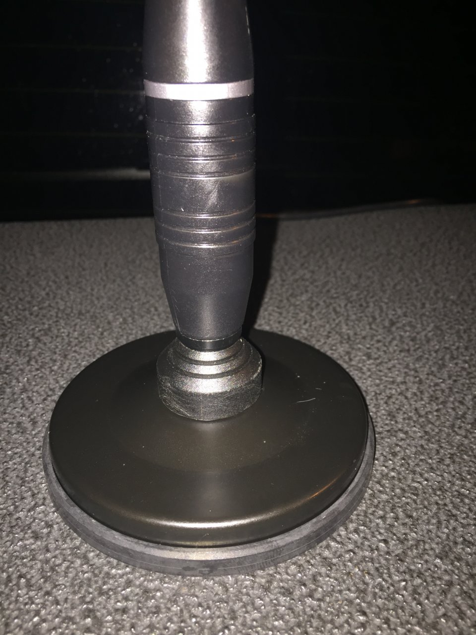

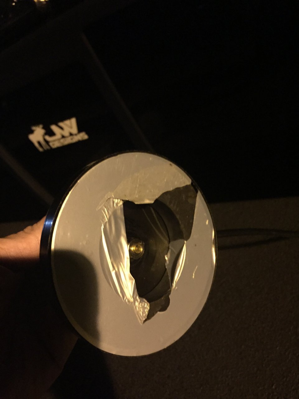

    I have a Cobra 29LX and Cobra 42" 300 watt antenna. Dont ask why, but I punctured the foil thats between the magnet and rubber protector.

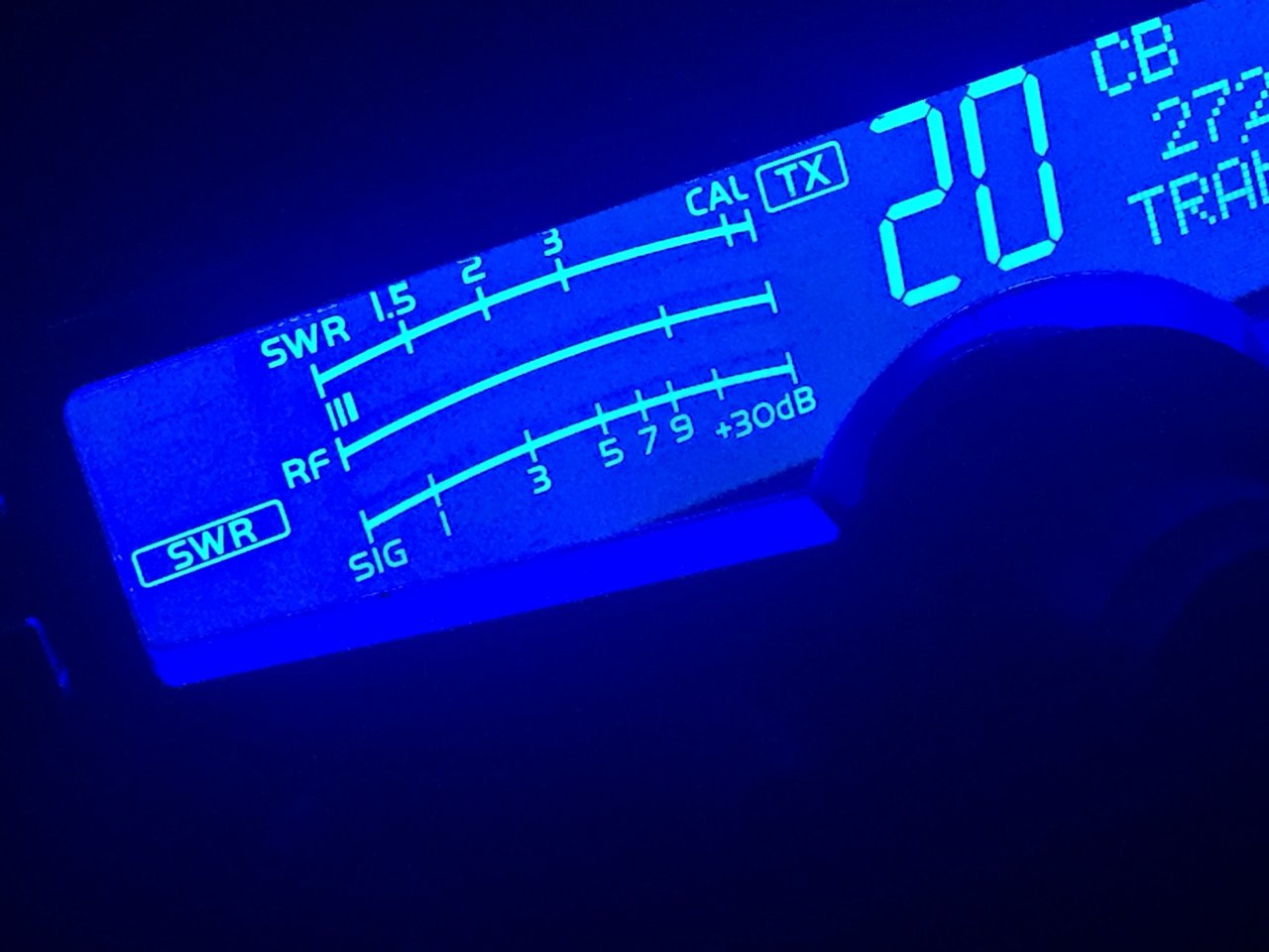

    My SWR is decent. It fluctuates, but its decent. But I have to turn the squelch nearly all the way to the left to even get static. When testing the radio (just a stones throw away) with a handheld Cobra cb - I can barely be heard. Its very muffled.

    1) what issues can this foil puncture cause? I understand it acts as a capacitor. But I am getting continuity between the bottom stud (only exposed because I punctured the foil) and the chasis, as well as the outer shield of the coax at the radio. I get continuity on the bottom stud and chasis no matter where the antenna is Even if I hold it.
    There is no continuity with the broken foil and any part of the antenna. Which leads me to my next question...
    2) if i have continuity and a ground on the bottom stud, why is the foil even necessary? Is there another ground required? The base of the mount has no ground. No continuity. Is it supposed to?

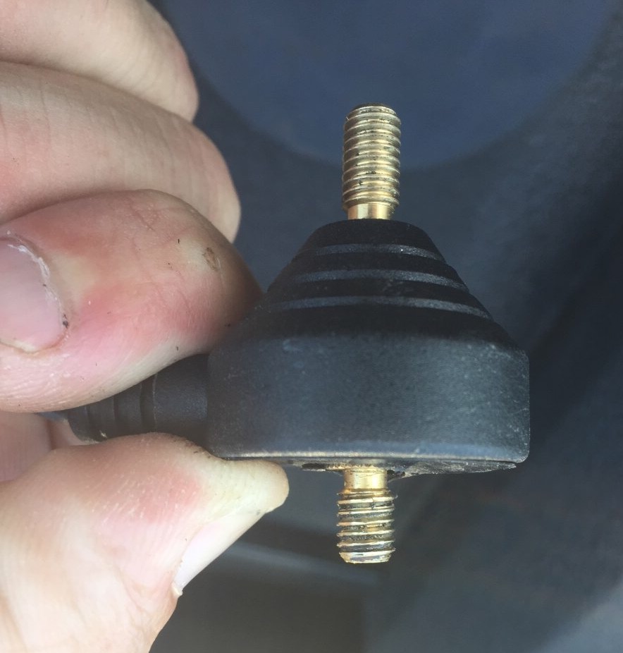

    3) when removed from the mount, my antenna has 2 studs. They do not have continuity with eachother. This is where I get confused. Is the lower stud for ground and top stud for power or another ground?
    I have no available coax nut or pin to test on the antenna side, just the radio side. And what about the mount itself? Is that grounded?

    A capacitor is two metal bodies with an insulator in between, so with the antenna, the body that you attach the magnet to is one part, the rubber (and possibly the foil coating) is the insulator and the foil metal is the other part. The stud just hanging out won't do a thing, there is no balance to the antenna circuit.
    The use of a capacitor in a mag mount is to add a balance to the antenna system, without it, it is useless.

    Quote: "There is no continuity with the broken foil and any part of the antenna."
    As you noted above, since there is no continuity involving the foil, I would just replace or repair the punctured foil with a new piece of foil to cover the bottom like it came from the factory.
    Then, I would use the antenna. It it does not perform satisfactorily, get the 3 foot Wilson Lil Wil as Mike suggested. If you want a longer magnetic antenna, the Wilson 500 is just over 4 feet, and the Wilson 1000 is just over 5 feet. They are all great magnetic antennas, about as good as you can get in their length categories.

    I imagine the torn foil on your Cobra antenna is a problem. The missing rubber part is not a problem. I had no measurable effect once I tossed my rubber piece out. I imagine it actually hinders performance (in theory) because it increases the distance between the foil and car, decreasing the necessary capacitance.
