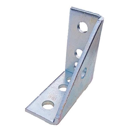

    With a little fabrication anything is possible. You could have a fab shop cut threads on the round part, and make one of these out of stainless, and sandwich this between a couple giant nuts torqued really tight.

    Yeap thats the one im thinkin of..plus it adds a smidge amount of metal under the antenna..

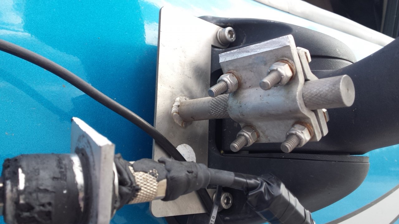

    My Wilson aluminum bracket broke a while ago. A coworker fabricated replacements for himself and me out of fairly thick flat stainless steel stock and a large stainless steel bolt for the antenna bracket perch. Much sturdier and swr shows as 1.1-1 on all forty channels according to both the radio's meter and his external meter.

    I bought a k40 mount..Same as basic ant mount just thicker material..Not the one i wanted but it will do for now..

    The bracket he made looks like the Wilson one, just made of stainless steel

    Got that already,bought it fr bobs in pa..
