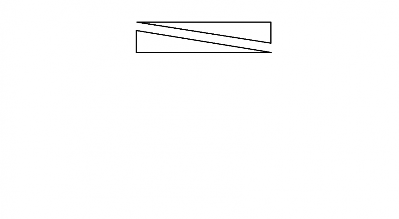

    This was on a step deck with an aluminum floor not an RGN, the crossmembers are aluminum too. There was between 12k and 15k on the single crossmember on each side and there was obviously a soft spot in that crossmember from previous minor damage or possibly the axle was out of alinement and put more weight in one side of the crossmember than the other. Never the less, yes heavy oak planking spanning at least 3 crossmembers will spread the weight and should stop this from happening but why would you carry this on your Conestoga step deck when you are running spot market freight 80% of the time? A couple hardwood 4X4s are standard dunnage carried on that same trailer and the wedges I recommend can protect the crossmembers almost as much as the long planking will, especially on an low riding indoor machine with solid rubber wheels.

    Yes many counterweights are almost gravity mounted with only stabilizer bolts but these wedges can not lift but they do support the counterweight on the main beams were the trailer is strongest.
