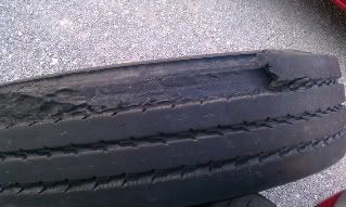

    AH!!! Those darn caps always coming apart and killing people not to mention the millions in property damage!! I lost this one yesterday only had about 4500# on it.
    Oh wait a minute I guess I should have mentioned the one above WASN'T a cap. It was a 16ply STEER tire (so no it wasn't ever ran flat) with around 75k miles on it. Continential HSR2 marked "made in the USA" (the ONLY 16 ply low pro 24.5 tire available) The part I'm really stoked about is what it did to my fender!
    Again I'm not saying virgin tires are junk, I'm just pointing out that virgin tires fail also.
