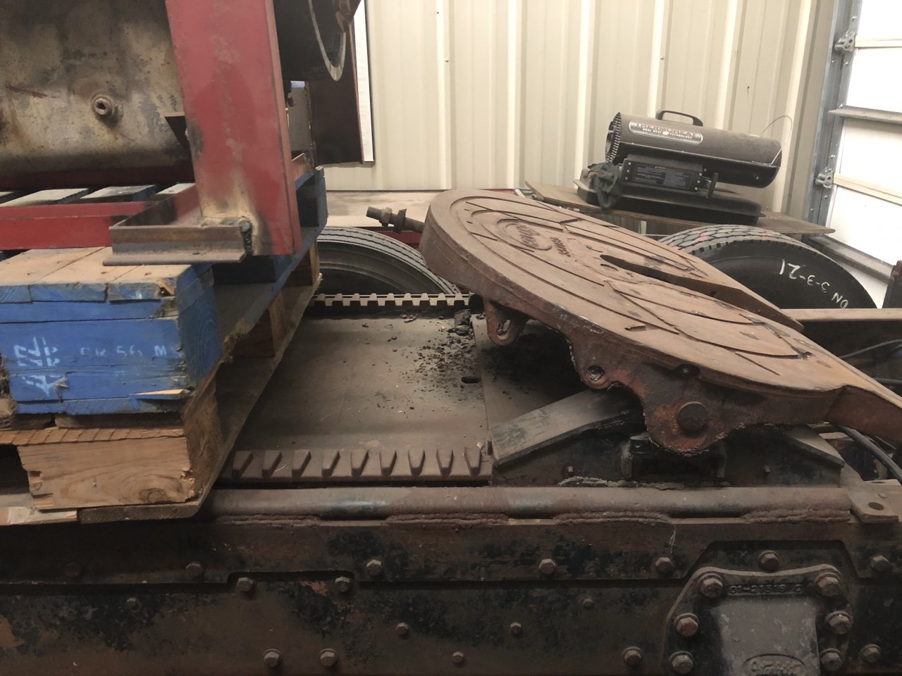

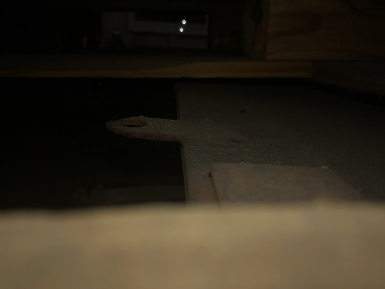

    this is the original Holland manual release wheel and slider plate on my ‘73 352. The older ones had a solid plate on them. The release lever was “borrowed” for another truck years ago. 2BC9AABD-02A3-46D0-ABCE-21D36DB232F7.jpeg I have a pallet with the engine and stand sitting on it so the pic came out dark but this is the tab for the holding rod.
