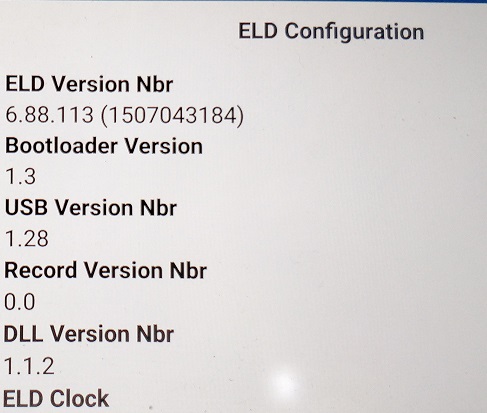

    We should probably start comparing hardware, firmware and software versions. I have been on JJK(forced from RM) for about a month now. My hardware version is 2.5 and the software version is xxxxxx.168. I haven't touched the odometer calibration since 03/15/2018, it was 3/10 of a mile off. This is a 2012 Cascadia w/ an ISX using the j1939 port.
