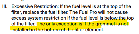

    NOTE 2: An easy way to determine the difference between vapor and air bubbles is by temporarily removing the filter element from the Fuel Pro. Fill the cover with clean diesel fuel, replace the vent cap and re-run the outlet fitting sight glass test. If there are no bubbles present in the sight glass then they were vapor. If bubbles are still present then they are air. If air bubbles still exist, re-run the test in NOTE 1 to eliminate the chassis plumbing as a variable. There is no troubleshooting or repair procedure required for vapor bubbles. Vapor bubbles do not cause performance issues and will not be present after the lift pump.
    I had no air bubbles in the clear line from housing to fuel primer bowl with the filter removed but with a filter in much air, a 3mpg loss, and low power. ???

    You cite from p.12 of the 382 Tech manual. Go to page 13, specifically II, it talks about performance problems without air bubbles. Can't hurt to perform the other tests on page 13.
    Since you tried several other units and that did not solve your problem it is highly unlikely that the problem is with the Davco. Page 13 II should solve the problem.

    I would double check for the grommet.
