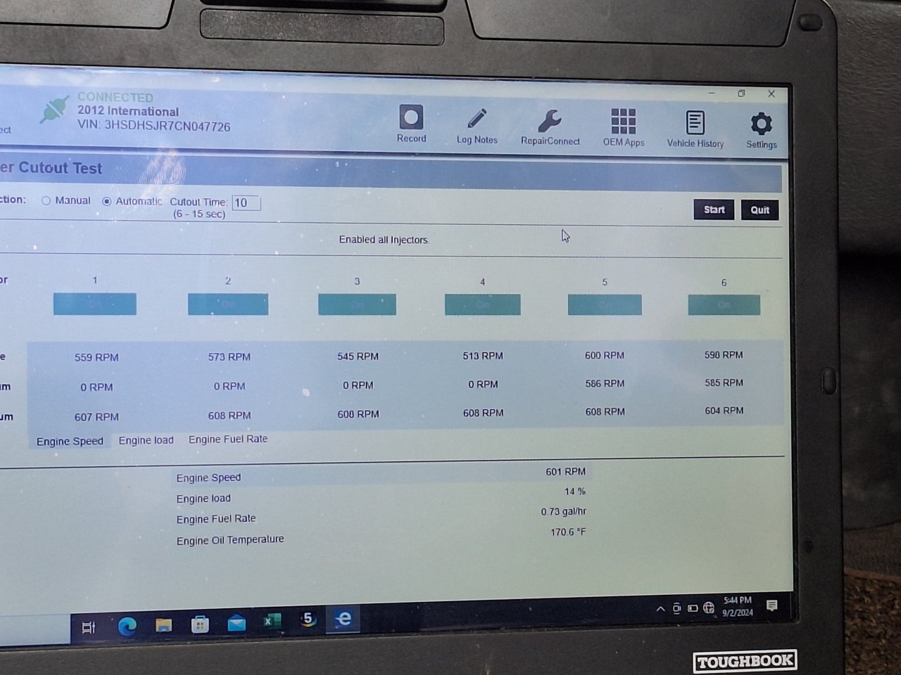

    Thank You Heavyd, This truck is not working any jobs so getting a load on it and finding someone to do a test and snapshot may take awhile. May I ask what software is required for that test on a 2011/12 Maxxforce 13?

    We use Navistar Engine Diagnostics.

    May 15, 2022
