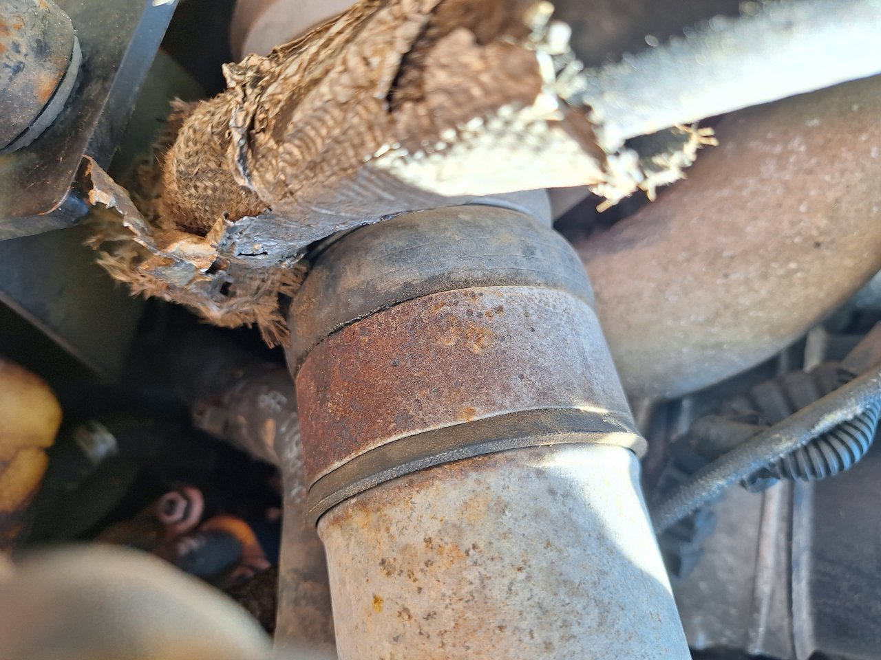

    It's a bit hard to tell, but that looks just like something out of my engine haha. Darn Maxxforces are a hornets nest for sure.
