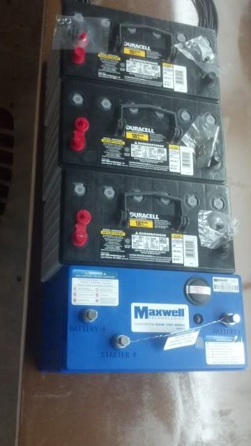

Just got mine together to replace my 4 batteries today. The Maxwell ESM from Truck Country of Davenport, IA for $747 plus tax and shipping and 3 Duracell deep cycle AGM Marine Batteries from Sam's Club for $179.32 each plus tax.

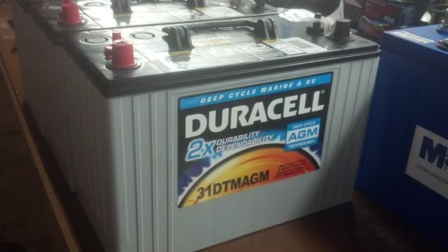

Here is the AGM battery I am using.

I am going to replace the main batteries with these and add 4 more AGM batteries on the other side to have 7 total deep cycle batteries for nothing but hotel loads in the truck with the Maxwell ESM for nothing hut cranking the truck.russellkanning, Cowpie1 and gregbo Thank this. -

The 7 new AGM batteries rated at 105 AHs each = 735 AHs
Big truck fridge uses around 6 amps/hr
8,000 btu AC unit during the daytime will use around 42 amps/hr
6 + 42 = 48 amps/hr x 10 hr break = 480 amps
Batteries 735 amps - 480 amps needed for 10 hr break = 255 reserve amps
My existing solar panels added with my new solar panels should add back around 150 amps over that 10 hr period to the batteries to increase the reserve to 405 amps after 10 hrs of no idle time. This will insure the batteries lasting longer because the reserve amperage never dropped below the recommended 50% capacity of the deep cycle batteries that would be anything over 367 amps reserve.
Deep cycle batteries are made for this 50% discharge compared to cranking batteries get hurt every time they are discharged more than 10% of there rated capacity.
This is what makes the Maxwell ESM used with deep cycle batteries a great long term choice for a true no idle electric APU system.vikingswen Thanks this. -
