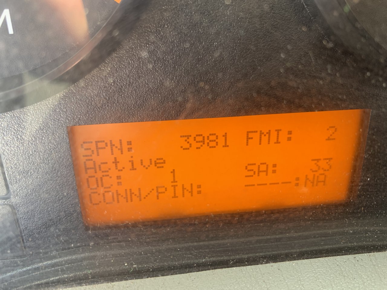

    I need your help I have followed you for awhile on this website but not needing any help but now I do lol I have a 2014 N13 12.4L. Has codes 3981 FMI2 I have had international scan this truck 3 times and they said it’s my intake throttle control valve coils be bad I just wanted to know what you think of any help please thank you
    I know the code leads to the EGR feedback position failed but trying to get to why it failed ? Please thank you

    Double check your code. I don't have 3981-2 in any N13 material.

    This is the code from the dash truck is 2014 international

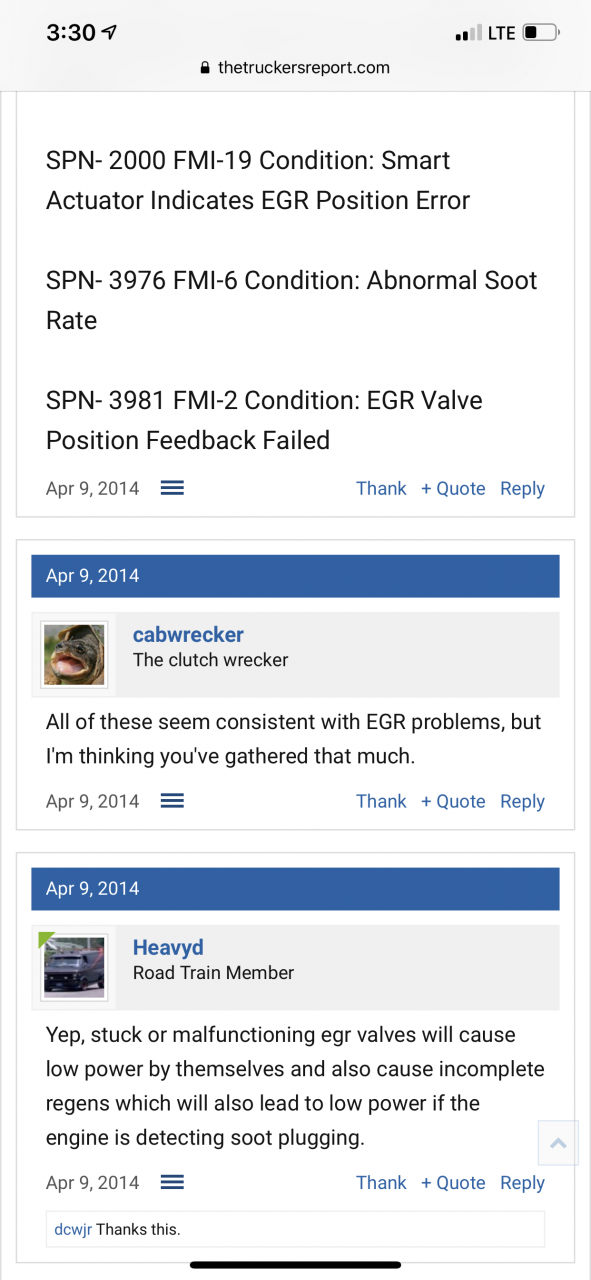

    I seen you answer on this back in 2014 April lol same symptoms
  11. Rollerorcker06
    Rollerorcker06 Bobtail Member
    8
    1
    Jul 13, 2019
    I seen this from some time back same codes I got but international is telling me that it could be my intake control valve making the EGR it function right
