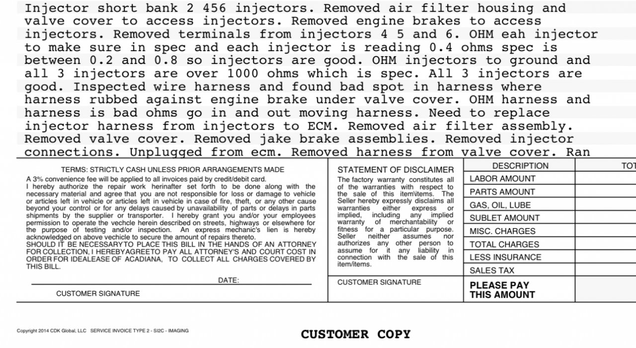

    So the dealership is saying I need a new injector harness.. Hopefully that’s the only issue..
  8. 2013Maxx
    2013Maxx Light Load Member
    134
    41
    Jan 17, 2018
    I wanted to update for anyone that may have this issue in the future. They’ve found rubbed thru wires on the injector harness. It was rubbing on the Jake brake housing. I will be picking up the truck on Monday. And Heavy D thank you again!!
