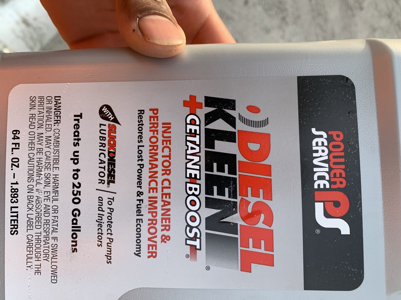

    I put some of this in the tanks and a little in the fuel separator Friday and things have gotten better. FDDC1458-C266-43CF-9571-AB4680E26699.jpeg CC5F594D-0741-4F41-BBAC-230B85BD8158.jpeg
