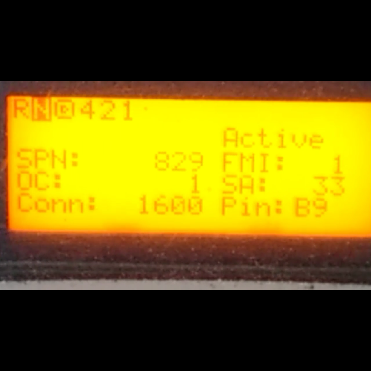

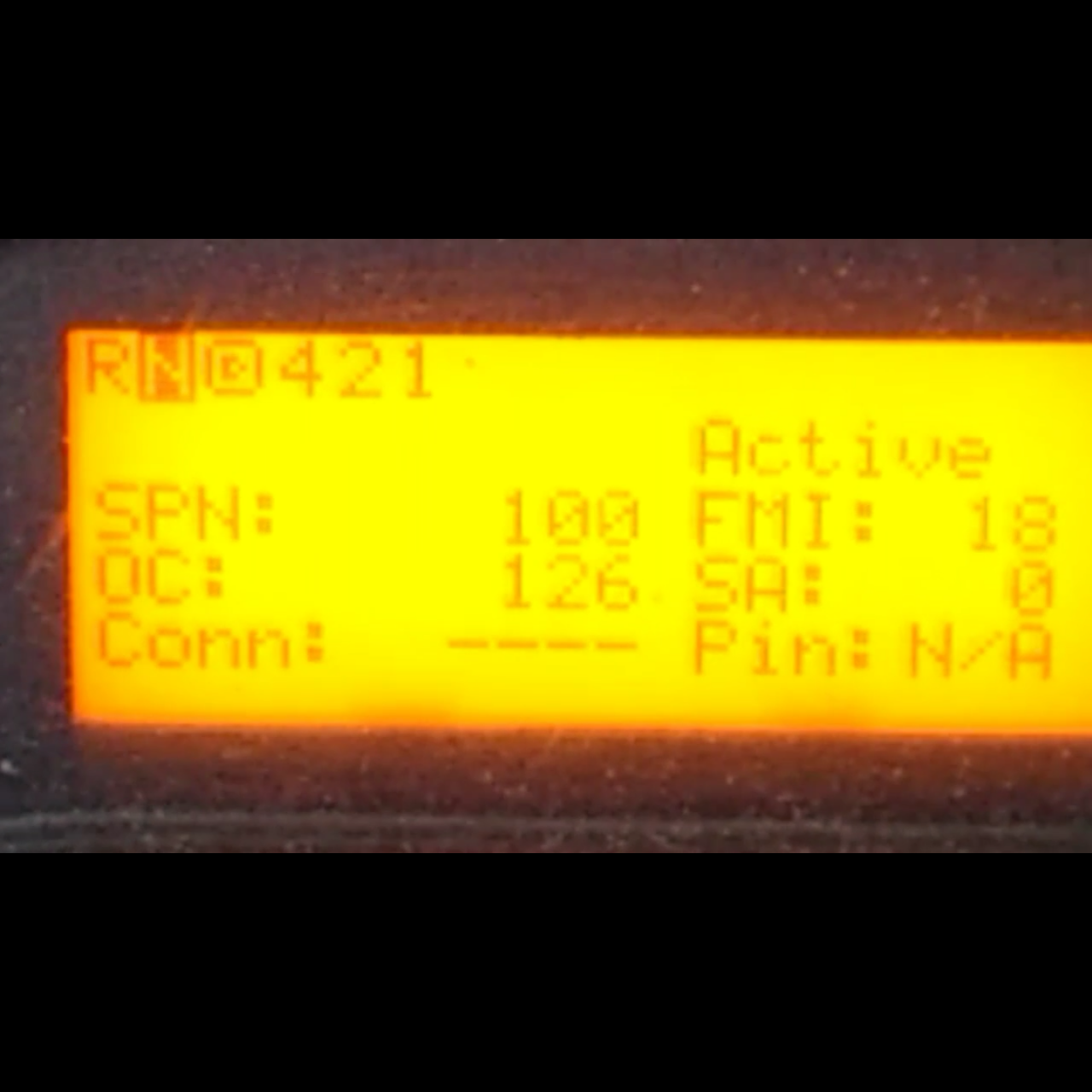

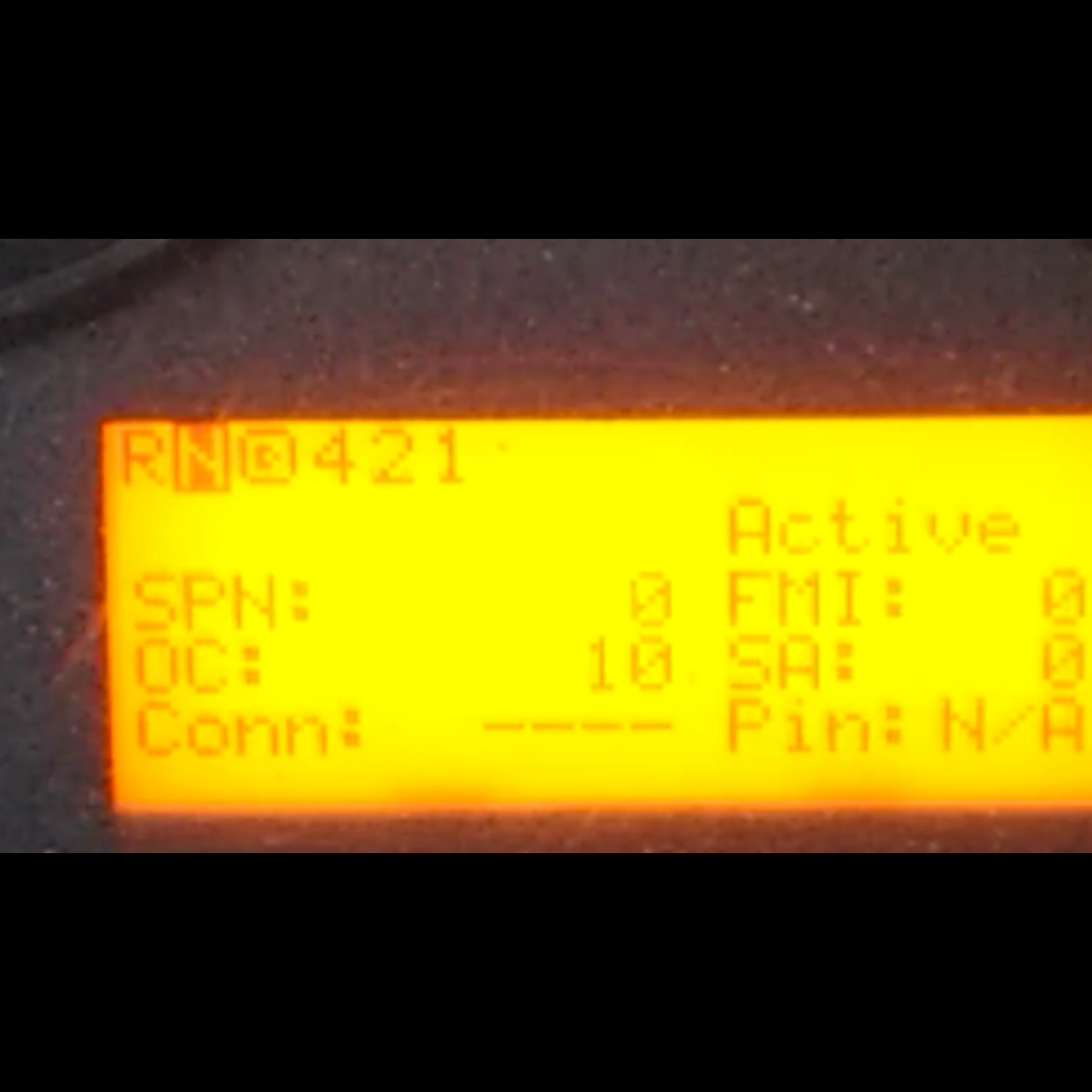

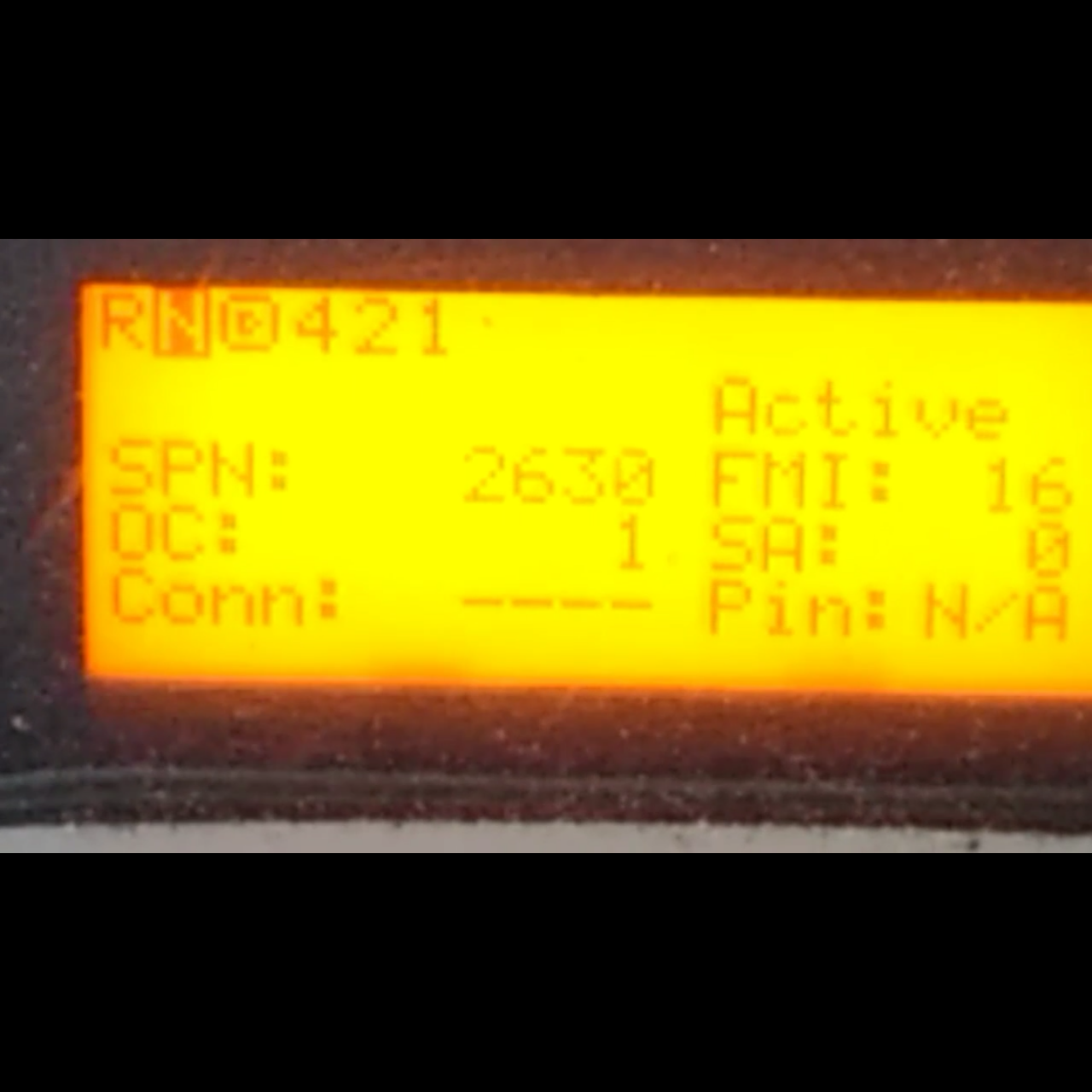

    How do you perform the cruise control button method?

    Press the cruise control 'on' button on the left side of the steering wheel, and simultaneously press the resume/accel button on the right side. Make sure vehicle is in in park, and emergency brake engaged. The gauges will do a sweeping motion first and then display the fault codes on the dash.
    Keep in mind that this doesn't always work on every model. It worked on my 2012, but not on the 2013 International rental unit I had.
