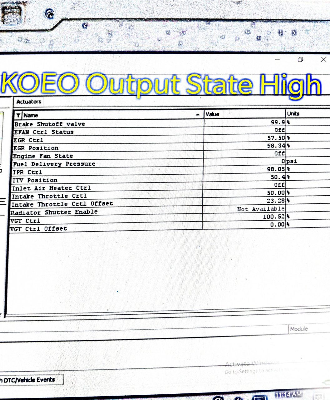

    I'm having an issue with a 2010 Maxxforce DT (07 epa) Truck begins running great with power like nothing is wrong but eventually at some point at full throttle starts smoking black and white smoke, stumbles losses all power for that moment. The problem mainly stays but sometimes goes away on it's own at next acceleration. Already changed Map, cleaned mat and ebp. Replaced turbo actuator. Only place I have left to check for air leaks is CAC everything else seems fine. Breather was cleaned as well and can hear it working after shutting off engine. I have no codes until I do Standard KOER - 3338 EBP unable to build during test and Air management Test - 3347 VGT control under duty
    Any ideas?

    I checked throttle body and it's open. Ran output state high and low a few times and no codes. It now doing some kind of sound like if the egr or vgt or something else is stuck or something. I posted videos and you can hear the sound here around the middle.
    Check engine light if for aftertreatment sensors because exhaust pipe is disconnected to diagnose current problem.
    I'm thinking maybe a bad egr valve or throttle valve that's working most of the time but sometimes it's not and tricking the ecm that it is working or maybe a wire at one of the connectors that's not making proper contact at times

  10. Young_simba
    Young_simba Bobtail Member
    13
    4
    Jun 28, 2019
    I disconnected the ebp sensor and the stumble/ weird sound did go away. It still throws black smoke at take off and a bit slow to build speed but it does make a difference. When I connect the sensor again I lose all power at times and now get a bunch of white/black smoke. I checked the ebp tube and it's free not clogged
  11. Heavyd
    Heavyd Road Train Member
    7,830
    6,282
    Feb 4, 2009
    That sensor is used with others to calculate what the turbo and egr valve does. When it is disconnected, the engine runs off of default values. That sensor could be faulty.
