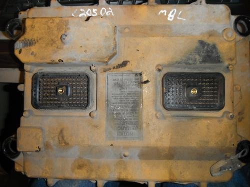

Is my ECM a 40 or 70 pin? I've seen both online.
Well I dug a little more and found just one person stating I have a 70 pin ecm. It has two square connectors
looks like thisAttached Files:
