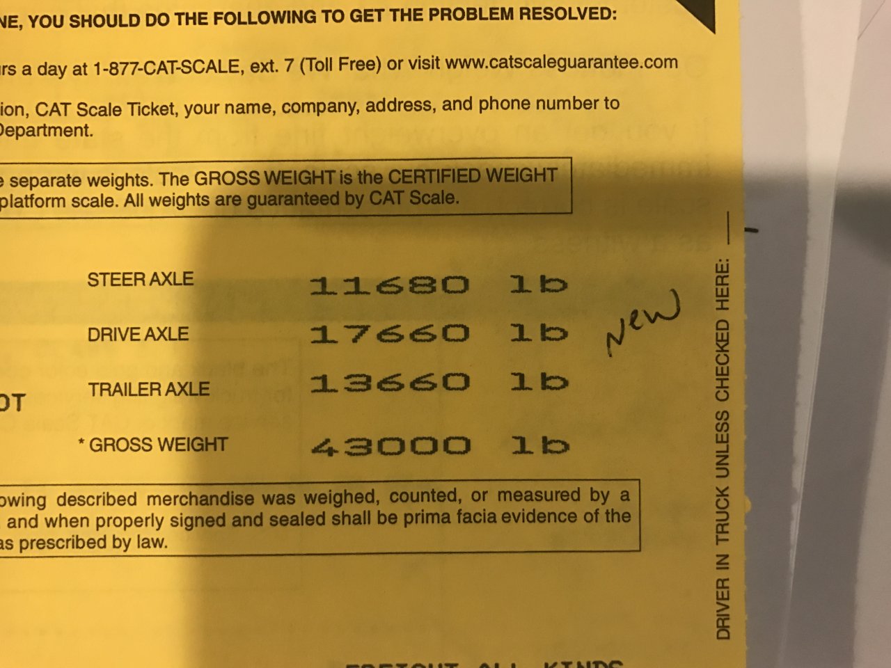

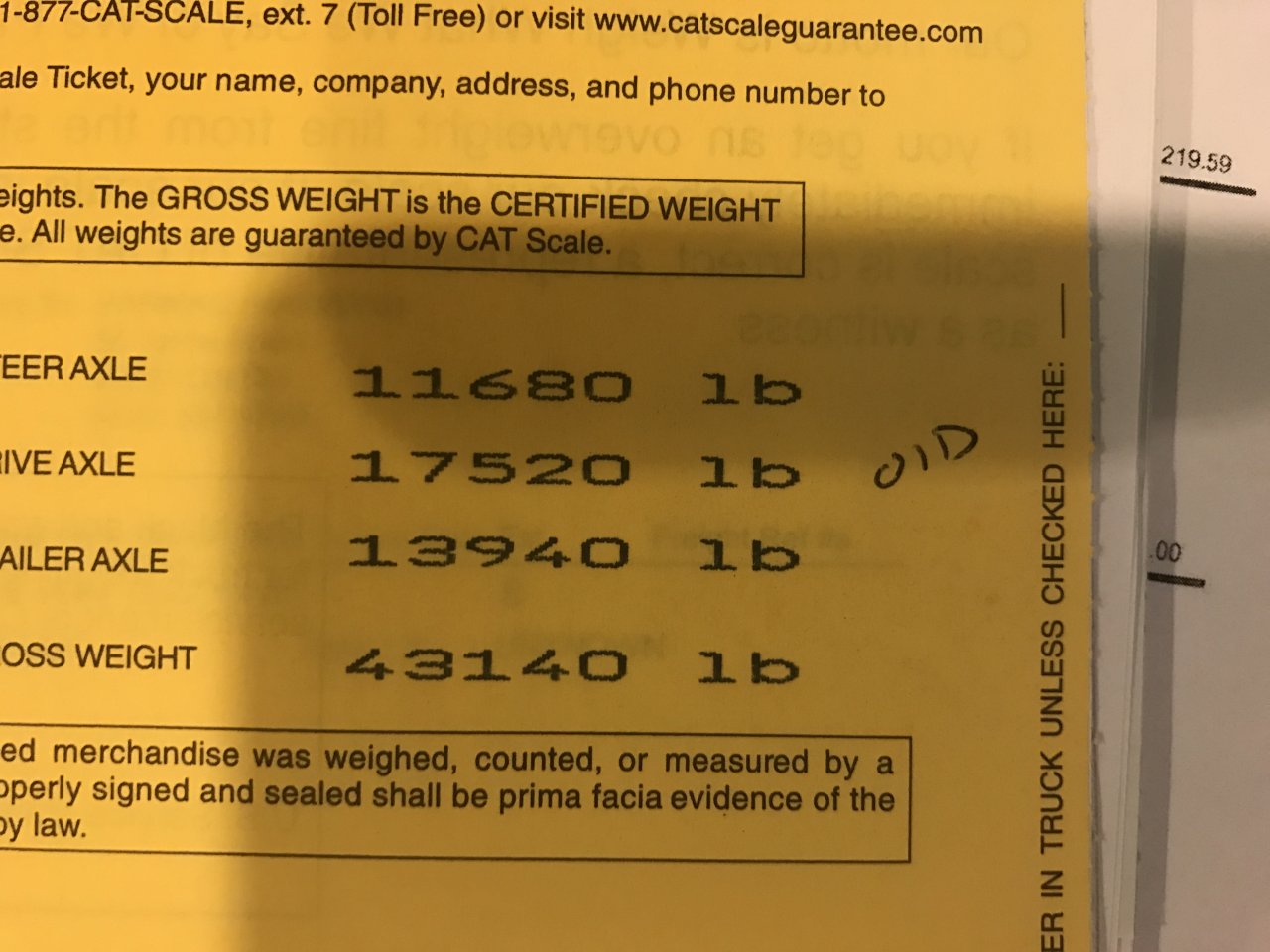

    So I had a chance to look over the past couple of weeks MT weights. Seems to be that older tanks are about the same overall weight as a new 331. Obviously, MT weights are going to fluctuate because of the amount of fuel in my tanks and if there is any product left in the tanker, but there isn't more then about a 500# swing.
    I believe my truck is about 21,000 with full fuel and me. Since I am never full when I scale, i'm somewhere in the 3/4 - 2/3 full so that would put my MT weight around 20,400 - 20,700. So an MT countryside 331 tank is about 22,250 give or take a 100# either way.
    Older trailers:
    42780
    42780
    43080
    43140
    43280
    42860
    New Trailers:
    43020
    43000
    42740
    42600
    42880
