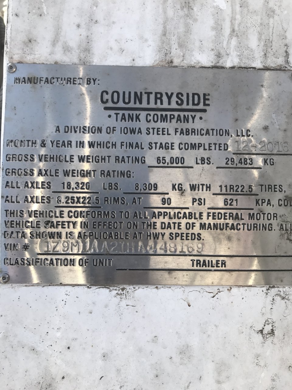

    I'll try to remember to look at my countryside, i thought it showed tare weight but could be wrong. I was told by the buyer for our company last year that he could get westmor for less money than countryside. He did not show me the quotes so he might not have been telling me the truth.

    Actually, that would be about right. In between 43,400-44,300 and my truck with full tanks is just shy of 21,000.

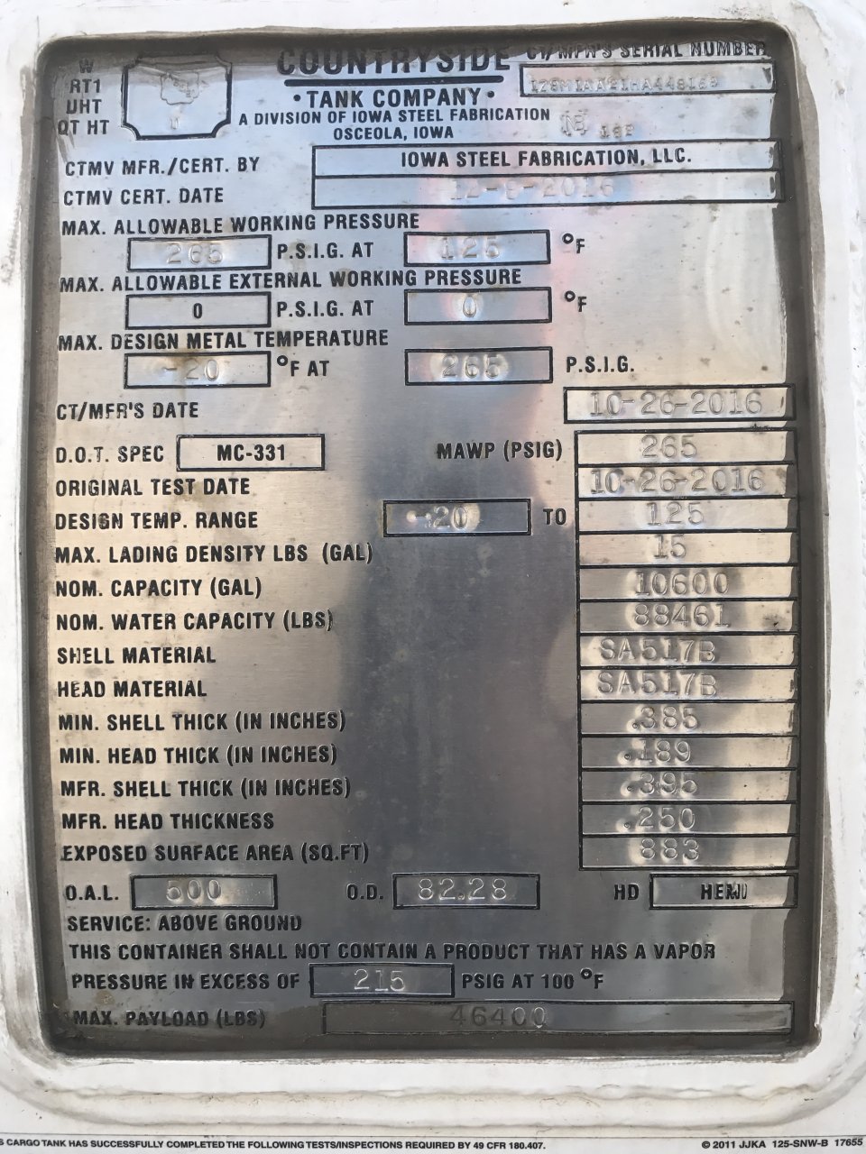

    That may very well be what they figured and why they didn't out a tare weight on it if that's the case. That's the best I can figure anyway. I'll have to do some looking next time I'm at the yard and see how many of our trailers have a tare on them.

    I've never seen a newer trl without the tare weight on the data Plate. Newer data plates have way more info on them then those ancient bottles I've seen in the past.

    GVWR 65,000 - maximum payload 46,400 = 18,600.
    I bet your empty weight is right around there.
