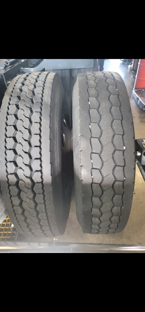

    So I always hear and have read many threads on here about md alignment. Heck they're on the sirius trucking show. So I always looked for one I'd be near as they're supposed to be the best. Well they're crap. 500 miles after their alingment tire wear. 8k miles later I'm at a truck stop and they're showing me how out of wack it is.
    Maybe their main shop is great? Idk. I won't ever go to one again though

    The picture you posted above of the duals shows two completely different tires with a big difference in the amount of tread each has. Was it that way at alignment? You should never have more than 4/32 difference in thread depth of two adjoining tires.

  11. AModelCat
    29,744
    165,201
    That was my first thought as well. I'm not seeing only 1 tire on a set of duals getting chewed up like that and not the other if it were alignment related.

  12. danny23tx
    danny23tx Road Train Member
    1,494
    2,324
    Feb 16, 2016
    Austin,Tx
    Thats a huge tread difference.
