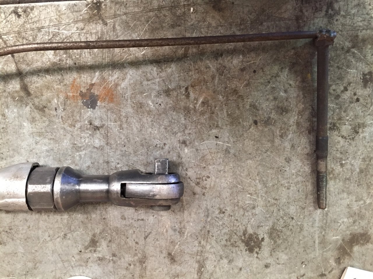

    The flywheel tool is just a ground off 3/8" bolt that goes through the flywheel housing and locates in a hole in the flywheel to get the timing position IMG_3805.JPG . On my 3408, should be same as 3406

    Like that custom tool! Oz

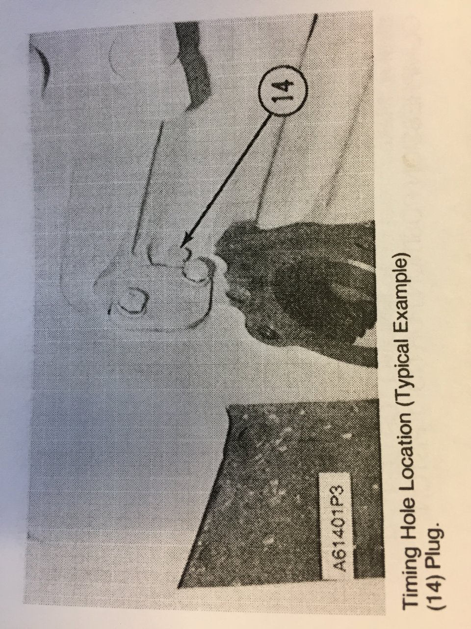

    There's no room under my V8 to do anything but there's a lot more room on the 6. There's a plate covering the hole on the flywheel housing with a long bolt and a short bolt, the long bolt you use as the locating tool according to the manual. The big hole in the pic is where the starter goes.
    Like I said, 3408 but mechanical 3406 should be same.
    Edit: don't ask me why there's 2 pics but atm busy in the shop changing an airbag.
    Edit again: The plate covers the hole for the crankshaft turning tool. The hole marked 14 is where the timing tool for TDC goes.

    Thank you for the wealth of info! You've refreshed my memory about the timing pins. I went and bought them both from CAT before I realized I could have made them myself. The short pin goes in the hole near the fuel pump and the big one goes back by the starter. The flywheel turning tool is a glorified hand crank starter.
