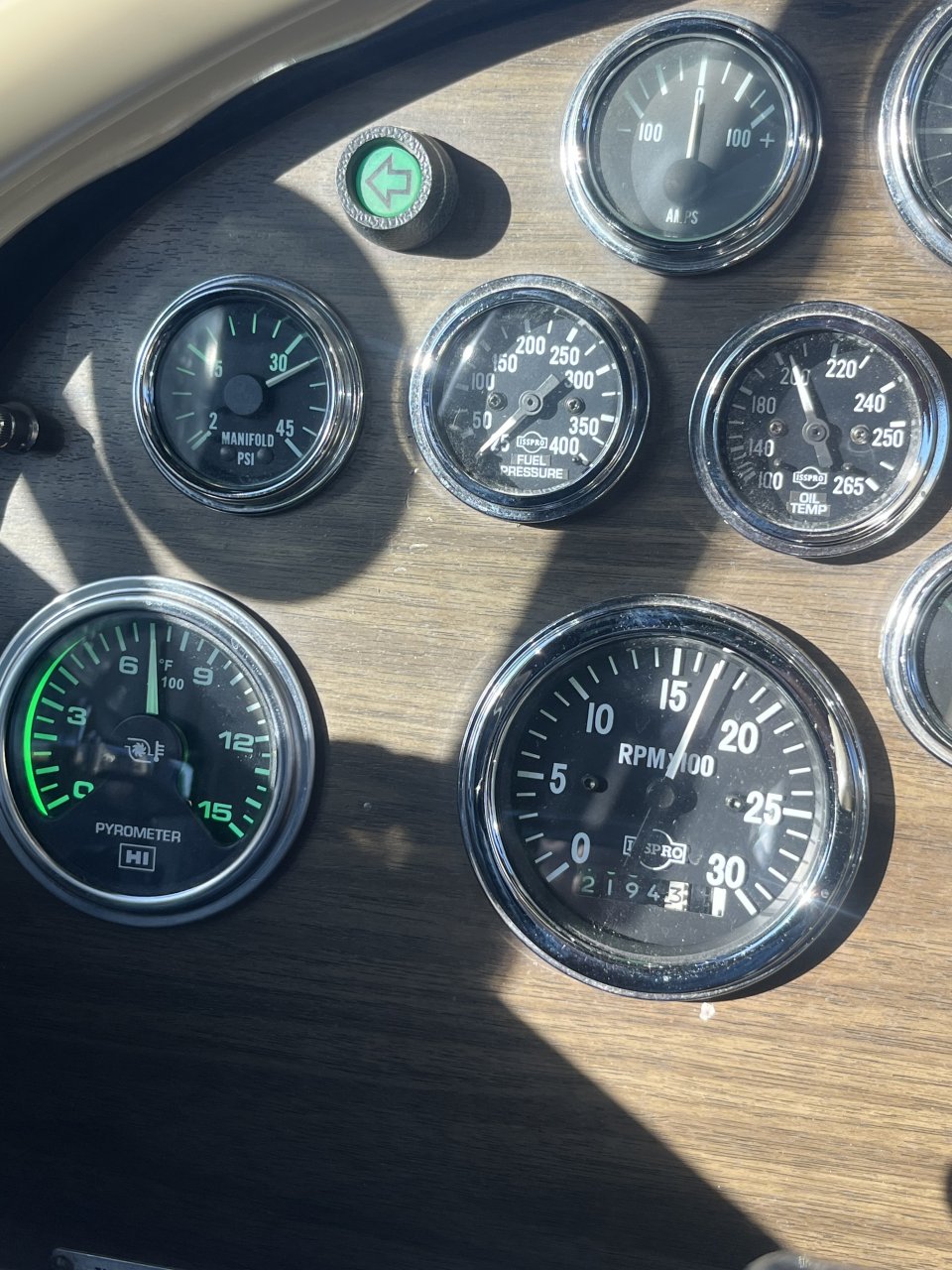

    IMG_2707.jpeg Picture from today.
    Topping the last long hill westbound on the Bluegrass Parkway in KY.
    If you’re not familiar with the hill, it’s almost 450’ elevation gain in approximately 2 miles.

    That’s some darn good fuel mileage for out in those hills, with old mechanical engine. I’d go out on a limb and say, it’s not smoking alot or excessively, with that fuel mileage. I’d also tend to believe the the timing at the cam and followers boxes isn’t off by much. The big cams and small cams, that I’ve seen turned up to the point timing becomes more of an issue, they’re hard on fuel, excessive smoke and hard to start. Particularly hard to start, if engine is hot.

    You are correct. It doesn’t smoke much at all, and starts very easily. Even at 0° with no block heater.
    It barely hazes on a shift the way I normally drive. If you gouge it on a shift you can get a cloud out of it, but I just don’t drive like that.
    And, I live by the motto, “Load it like a shopping cart, drive it like an old fart.”
    68 mph is my happy spot with this ole heap. 1,550 rpm with a 13 speed, 3.36’s and short tires. I come out of the big gear quickly because I like to be 1,700-1,800 rpm when I work it hard.
