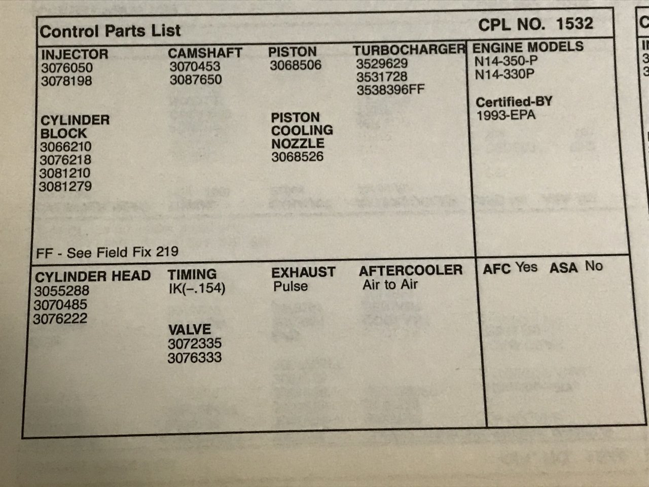

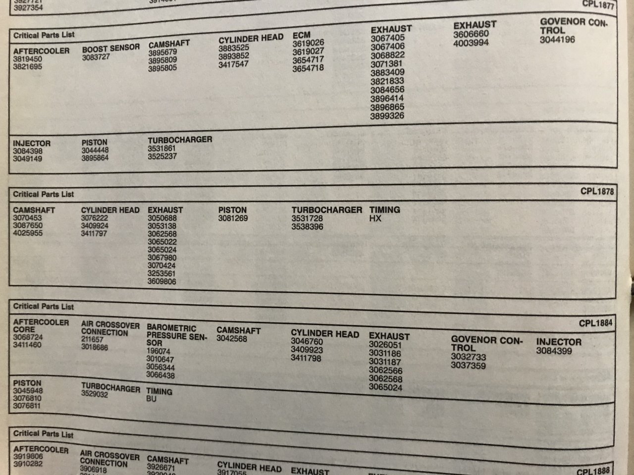

    I think the book I need to figure out parts is called CUMMINS FUEL PUMP PT TYPE G CALIBRATION VALUES but all the ones on eBay are for engines built before 1990. Does anyone have one printed around 1995?

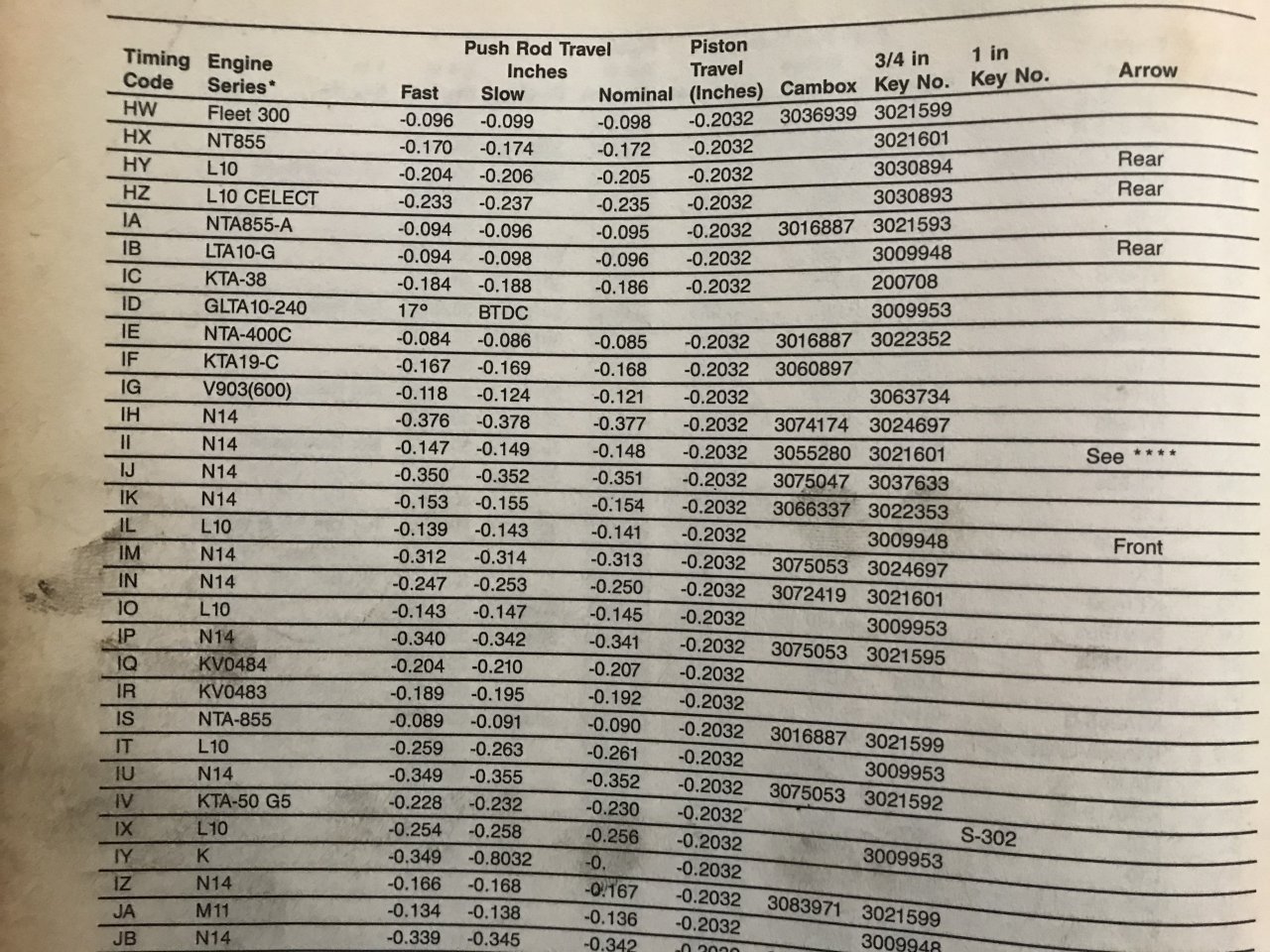

    The stc is there to address smoke at idle & light load conditions. When the engine is working the stc system has no effect on timing.
    The timing values I posted refer to the engine base timing. .154 & .172 represent the amount of injector pushrod travel left at 19 degrees btdc. Adjusting that involves changing gaskets between the cam followers & block. In your case you'd have to remove gaskets to move towards the .172 setting. There likely aren't enough there to remove to get what you want. In that case you'd remove the camshaft & install a different key.

    Many thanks. I’ll study this. If I give you a fuel Calibration code can you give me a governor spring and button #?
  9. pup
    pup Light Load Member
    252
    256
    Dec 3, 2011
    n.h.
    What's the code #
