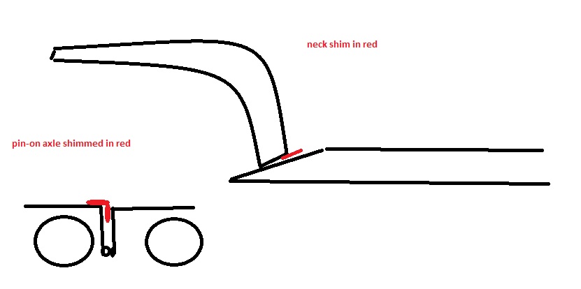

    I have no idea what a shim is. Will you explain this to me? I have heard people talk about shimming the Lift axle but not sure what they meant.

    A shim is a piece of steel used to take up loose areas at the neck and also some types of pin-on axles.
    Shims are used in pairs and usually carried in different thicknesses.
    cke, Landincoldfire, Feedman and 2 others Thank this.

    Got it. So an inch thick angle iron?

    every trailer is different, set the neck down and measure the gap about 2 inches in from the back.
    That will tell you the maximum thickness of your shims, then get some pieces of steel plate in smaller thicknesses so you can shim as needed.
    If your pin-on axle has top slop you can do the same, I found a welder that built me some shims that started with a 3X3X1/2 to set in the gap with a drop in shim set. shim set2.png
