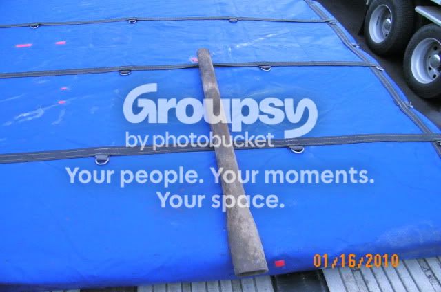

    I pulled out one stake & took some pics for you. They are 4' long & you have too make them to where they fit into the stake pockets of your trailer. I only carry 4 pipe stakes.

    Great! I didn't realize they were something so simple. I probably have enough pipe laying around the junk pile to do that, but it will be easier to buy what I need specifically for that purpose. The flattened section is how long? Enough to stick through the stake pocket two or three inches? Nothing holds these things in?

    My stake pockets are 4 inches tall by 3 3/4 inches wide.
    I just measured the flattened out end & on mine they are right around 6 inches.
    All that they are needed for is to make sure pipe don't roll off the trailer... With the pressure weight of the pipe & a couple bungees, they won't go no where.

    That is why I said that you have the resources to make en yourself. And that is why I snapped a pic showing the diameter of the pipe so you can do just that.
    All I was told I needed to buy were four & that is all I see on the Texas trucks hauling pipe.

    The set I had with maverick was not even that thick of gauge. Was galvanized pipe. Looked like galvanized fence post (tubing) that goes in between a gate on a chain linked fence. I had 2 footers and 4 footers. They are not for securement. Like redd said just to keep pipe from rolling off till you secure it. Some use 6 foot sections, but the few times I have used them I use the 4 foot sections. 4 is enough for a full length load, but if you get short pipe 8 is better. 4 for the front bundle and 4 for the rear bundle.
