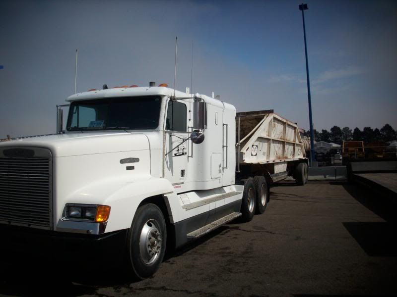

    its fairly inexpensive, i can see it paying for itself in lost down time and less road side service calls. let alone longer tire life. i think the cost benefit is more with super singles than with duals because with super singles you cant limp it anywhere with duals you can drag your air hose out drive a little ways stop air up again and drive till you get somewhere you can get it fixed not very practical with super singles as there is not another tire to carry the weight when the other tire is low. i cant see not running it for the price in my situation. especially because i am puncture prone.
    just think of the down time you have had in the last year (lost revenue) waiting for tire repairs, if you can get your tires fixed at your convenience vrs when it happens figure how much more up time you would have in your operation. let alone if you get stuck on the side of the road somewhere and have to wait for a service truck, then you have service call cost as well as down time. i think for me it would pay for itself within a few months. if my experience with this system goes as good as some friends of mine has ill retrofit every trailer i buy with this system.
    here is my truck and the trailer im getting this system retrofitted on

    well just a update the system is done being installed, everything seems to be working how it should. the shop did a nice clean installation on everything. they also fixed a light replaced my trailer light plug as it was in bad shape and repaired some questionable wiring that was on my to do list, replaced a quick release valve on one of my dump cylinders that was leaking and the total damage came out to $1422
