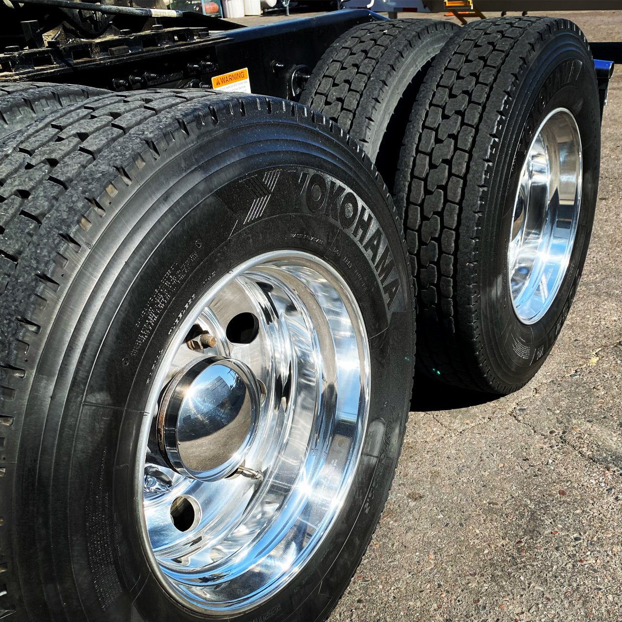

    sorry missed this... I recommend them for sure. The wheels were freshly polished when I signed on with Dave. The photos above were after 9-10 months and a winter running everywhere they salt and snow. I was stoked on how them came out.
