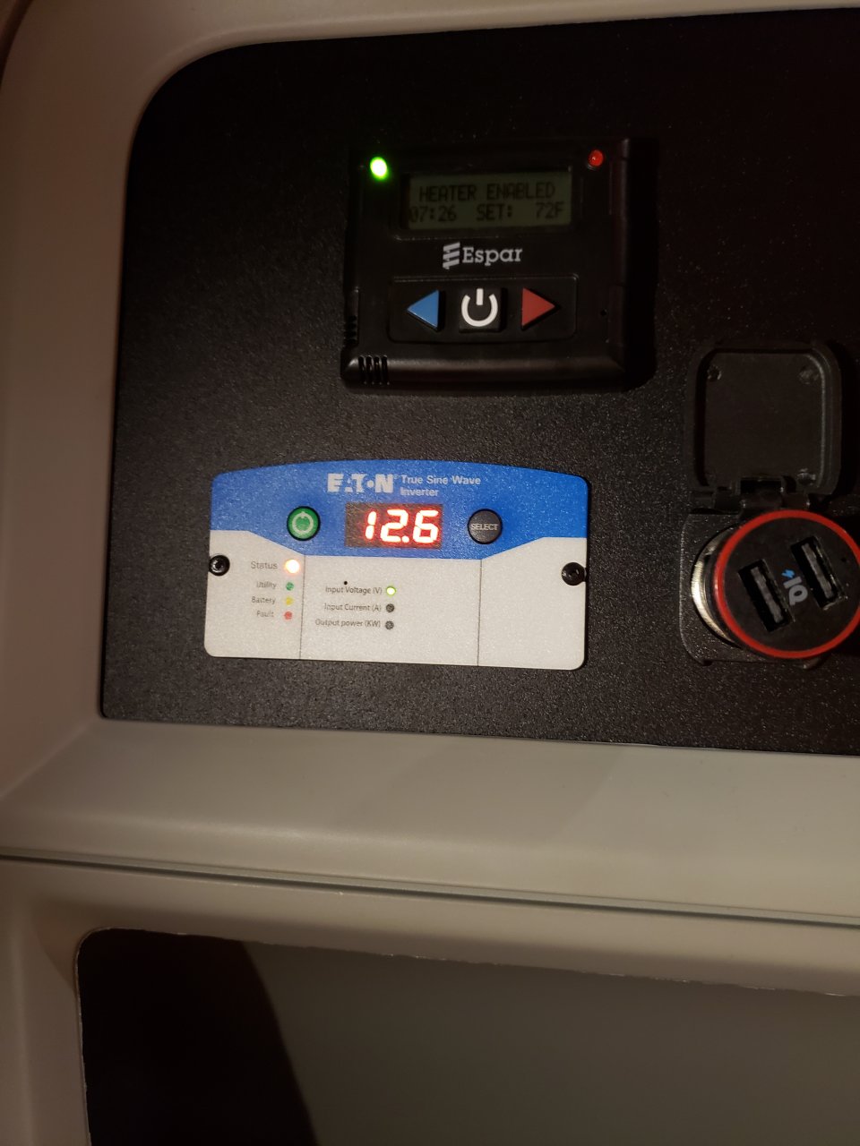

    Got a quick question for you guys. Got issued a truck today, and there is no power to the outlets in the rear - there a switch somewhere?

    Sounds like a fuse blown

    The 120 volt outlets or the 12 volt lighter plugs? The inverter needs to be turned on for the 130 volt outlets to work. The control for it is right below the control for the bunk heater on your sleeper control panel. 15761747885904538732410154018750.jpg

    Alright that got it. The button with the "power on" symbol was scraped off - looks like a black dot on mine. Also, the satellite antenna motor plug is the cigarette lighter looking one right? Just want to make sure I know what to leave unplugged when rolling.

    Yeah that's the one.
