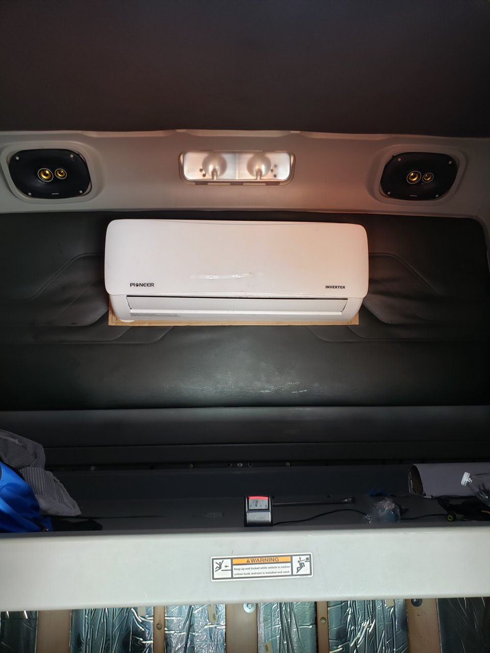

    So here is my setup. I still gotta do some details but it is fully up and running. For this I got
    Ryobi inverter generator 2300 $700
    12,000 btu Pioneer mini split with heat pump. $800
    unit consumes up to 1100 watts and because it is a soft start, it does not peak.
    Inside, it cools down to 62F. the unit itself basically has no noise. Generator no vibration to the cab. noise is minimal inside.
    This is a freightliner century 2005 and i have realized that a toilet has more insulation than this thing but it still pretty quiet.
    Let me know what you think and any ideas to make it better.
    thank you
    I dont understand the people that are saying this units will not last.
    First of all the system itself its very cheap
    my calculations are based on 10 hour idle per day
    10 hrs x $3.00 diesel = $30 x 7 days = 210 and this is conservative.
    at this rate , i will save $840 pero month. Enough to buy a #### system every single month.

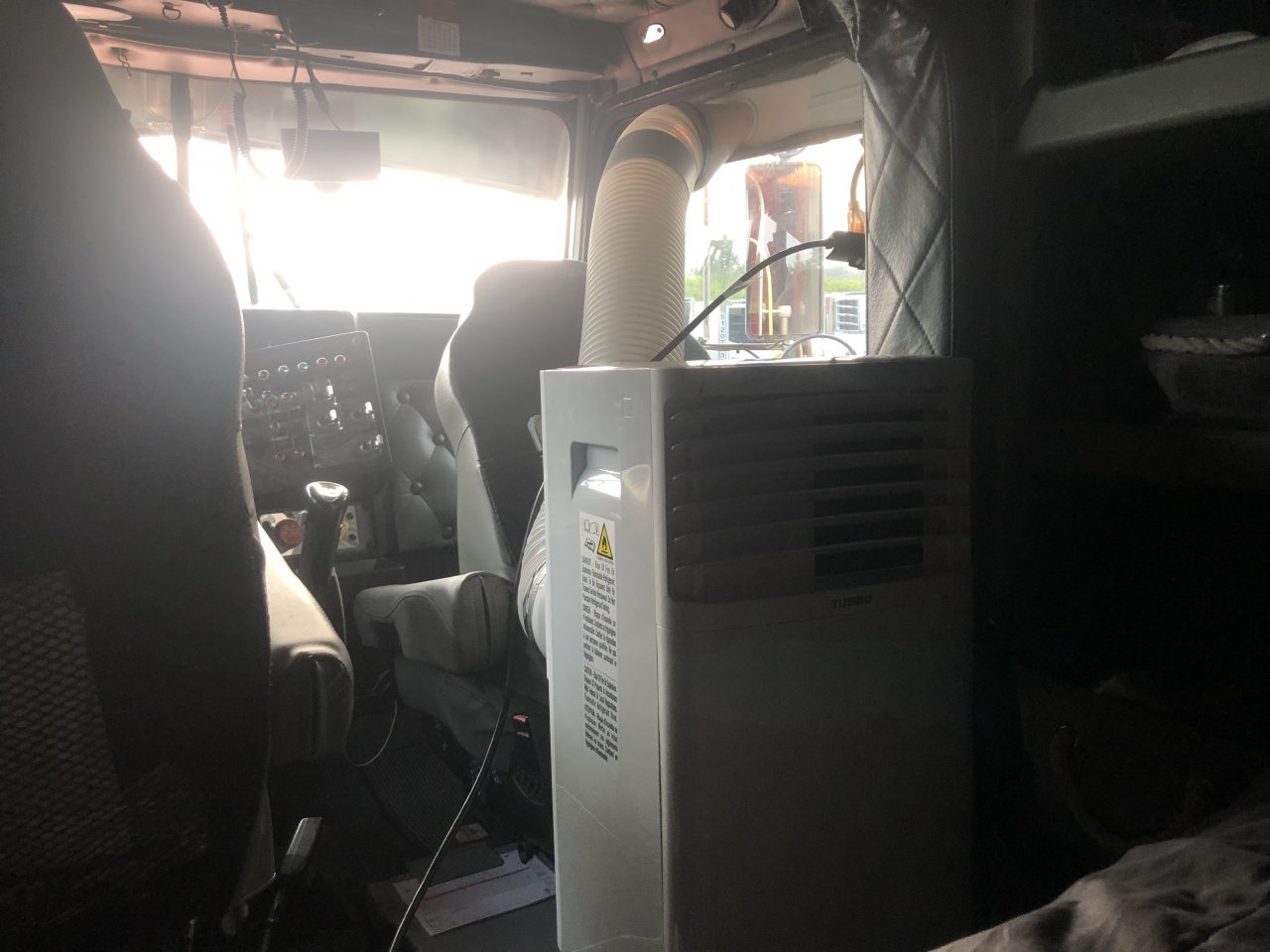

    I broke down and put a portable in and zipped the window piece to fit the passenger side, I just hate the noise/vibration more then the fuel consumption, harbor freight 2000 watt for $500 will run it for about 7 hours
    Rideandrepair Thanks this.
  8. Rideandrepair
    17,629
    57,047
    Aug 8, 2015
    I have a stand up single hose portable 8000btu, and ran it off a 2000w Chinese from Walmart, same as Harbor Freight model. It didn’t work very well. Generator ran it, once in a while it would stall out with the surge. Definitely want remote starter. I think actual fuel usage was still lower than a 3500, just tank capacity was less. I’ve seen YouTube tank modifications. Carrying the gas is a pita, and maybe dangerous. There may be some type of limit to the amount allowed for a gravity fed tank. An auxiliary tank with a fuel pump maybe? Rather just put a bigger tank on a 3500 watt, with remote starter.
