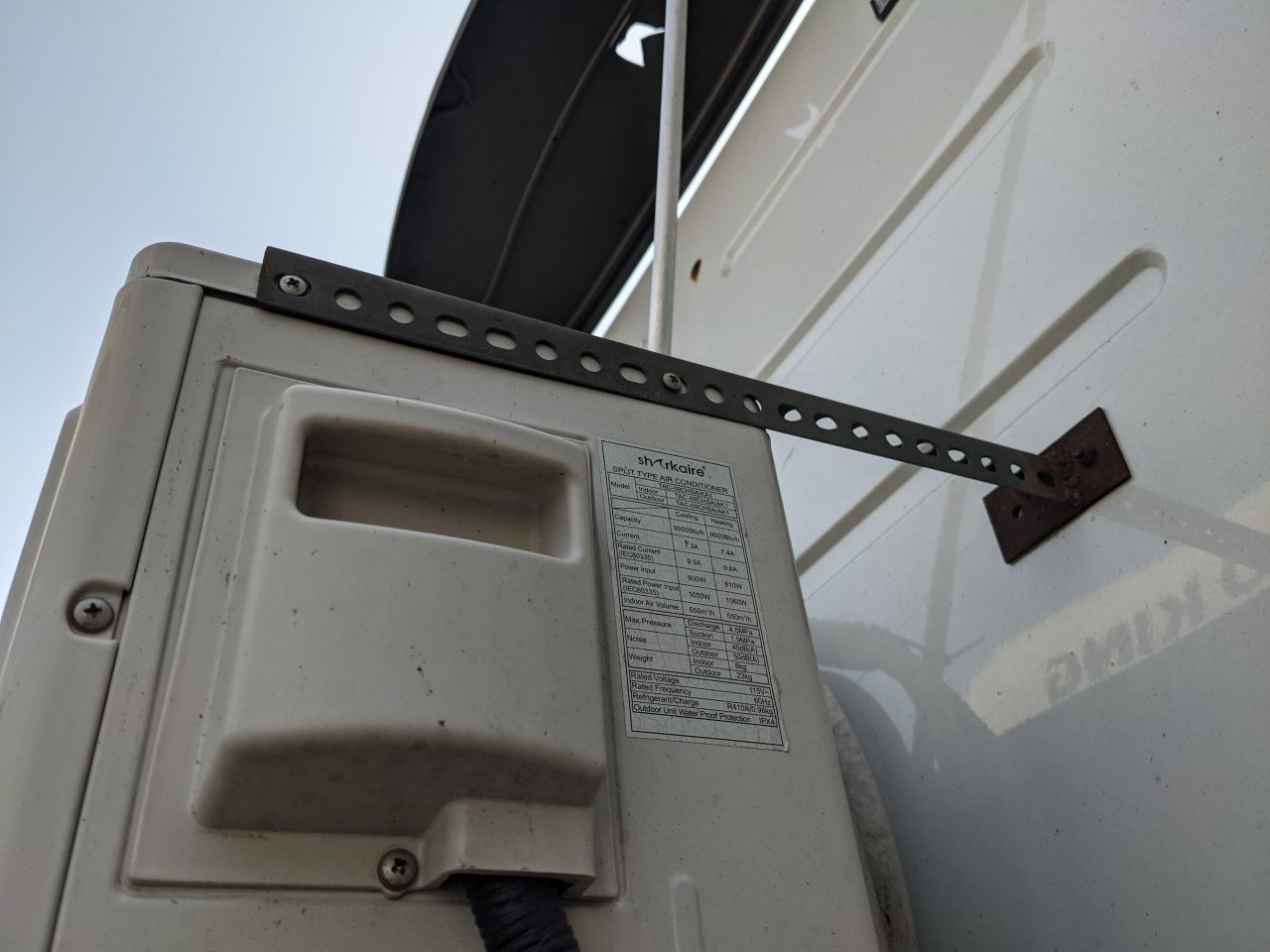

    I have done on my Volvo many years ago and would point on some installation mistakes what is not yet late to fix.
    1. Hanging pipes. They will vibrate and develop cracks over the time. Attach some brackets along the pipes Amazon.com: Pro-Grade, Slim, 1x .6 Cable Tie Mounts With Screws 100 Pack. High Strength, Black Zip Tie Bases For Wire Management. Permanently Anchor To Wall, Desk or Baseboard. Run Cords at Your Home or Office: Home Audio & Theater with blind rivets to hold pipes.
    2. Compressor unit top brackets. Compressor unit legs attached only with four spot welds and not designed to withstand rocking forces. You don't want your AC fall thru passing Prius windshield one day.

    If your truck leans sideways while parked, the condensation can potentially leak from the indoor unit. In this event, you're going to want to find some way to shift the indoor unit so that it becomes level again. On mine, I have a shelf right under it that I can wedge things under to get the desired level. Another idea would be to install the unit so that it leans to the right when you're on level ground, since(if it's like mine) the drain outlet is on that side.
    I would also suggest you use black poly irrigation tubing instead of the thin accordion style hose they give you for the condensation line.
  6. harold6091
    harold6091 Light Load Member
    120
    135
    Dec 25, 2018
    veey good idea. thak you

  7. harold6091
    120
    135
    Dec 25, 2018
    i
    put the hose on each side but it is a good idea to def change the material

    @harold6091, can you post the full link of that mini split rack you posted a pic of? I see it is Amazon but can't see everything to search for it.
    Thanks
