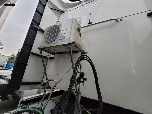

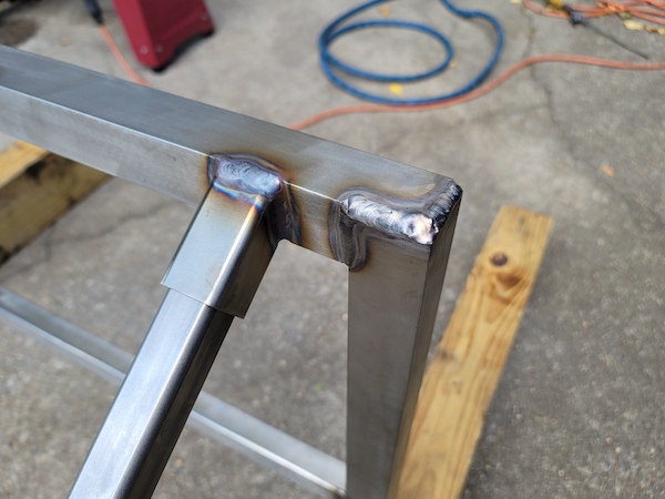

    One thing different, I chose to make my own outside rack out of 304 stainless. That part I got done, just need to drill some holes in it when it's time to mount. So this post is not entirely without content LOL. First picture is a mock-up, imagine the ground is the back of the cab. The feet on the bottom of the legs will bolt underneath with the leg socket just peeking out enough to clear, the upper piece straight to the back of the cab. Second picture is the upper corner detail showing how the legs fit. It's 1" thick wall sliding into 1-1/4" thick wall. There will be a bolt through it to secure it. I decided not to weld in place to make it easier to remove if I decide to do that at some point.

    I'm not the OP, but it's an Amazon screenshot. I didn't see that exact one, but there's many like it (link).
    Not that anyone asked, I considered something like that when mounting mine, but opted to make one instead. I've seen them out there and never seen signs they fell off or broke, but didn't ask either. I'm just not comfortable with the look of those universal mounts.
    The problem I see is that it's intended for the exterior wall of a house. That is, not bouncing down the road and only attaches to the rear face of the cab with a limited range of position to either hit a structural piece or place some sort of reinforcement behind the skin for strength. Still leaves a good bit of weight hanging out there just suspended by the wall too. I was thinking one trip through Indiana would probably do it in. Those chinesium brackets aren't very robust.
    I made mine with 304 stainless, and it's cut to exactly fit the structural pieces under the skin. 1-1/2 angle 1/8 thick for the frame, then the legs are 1" thickwall square tube. Both ends fit and bolt into 1-1/4 thickwall stubs, one welded to the frame up top, the bottom is welded to a piece of 1/4 flat that is attached to the frame rail under the cab. The attachments at the top/back of the cab go through a frame structure and also have a short piece of 1/8 mild steel steel 2" angle as a backer. Probably over-built, and definitely a bit more expensive. Probably $300 worth of materials, bandsaw blades, drill bits, welding rod, etc plus about a half a day to cut up all the steel and put it together.
    I've seen similar homemade racks like mine out in the wild, but usually bolted together hardware store angle that's maybe painted, and doesn't look as finished IMO. One or two I've seen use outside support legs attached up higher vs under the cab like mine. One like that I recall was hauling a reefer with a fairly short wheelbase Freightliner with the 5th wheel up pretty snug to the cab, and did it for a low mount that would clear underneath the reefer unit in a turn. Speaking of clearance, I did have to cut a few inches off the top of my pogo stick so it would clear that right hand leg when turning right. A few things to look out for.
    Really a 100 ways to do it if you put your mind to it. Measure once cut twice and all that.

    My frame attaches with thru bolts not rivnuts. I positioned them over structural pieces behind the surface, and also used some short pieces of 2x2 1/8 angle on the back to spread the load better. I cut some 1/8 rubber to make a gasket/soft mount between the frame and the cab.
    I been thru fitting a different compressor and it's not a big deal as you'd think. Long story short, I ordered the 22 SEER model on the second (my) truck and built the rack to the same dimensions as the first one. I discovered upon setting the unit that they had shipped me the 20 SEER unit, which is a bit smaller. The low effort solution was to bolt in a couple pieces of flat steel to attach the feet since they fell inside the frame. In hindsight, I'd say having to make and mount an entirely new frame would be unlikely.

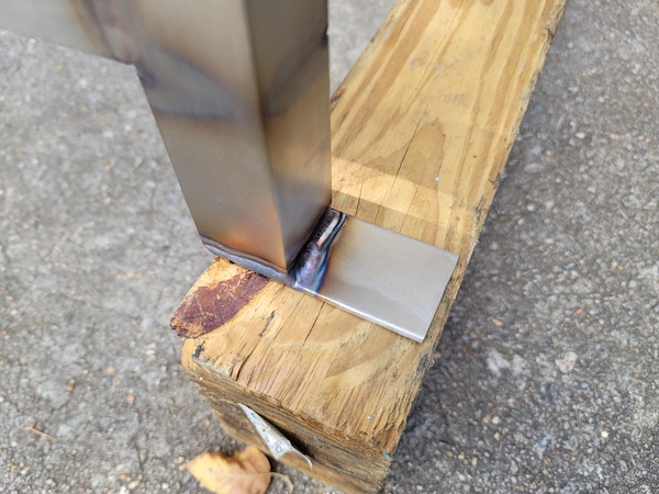

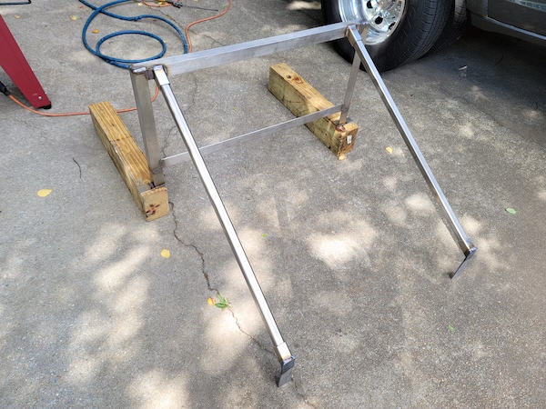

    Here's some detail pics from when I was building the frame. I know that installed pic may be a little unclear about how the thing is put together and goes on. Truth be told, nearly all of the custom fitting is primarily how it attaches to the truck. That is, attaching to strong enough mounts in the right spots. Making little modifications to fit a different unit after the fact, is less effort than meets the eye.
    This is assembled, imagine the ground as the back of the cab for perspective. The "feet" at the lower end fit under the cab, secured with bolts going straight upward into the structural beam they lay against. Since they extend about 4 inches under the cab, I set the frame up on 4x4's to make sure I had the angles right on the legs.
