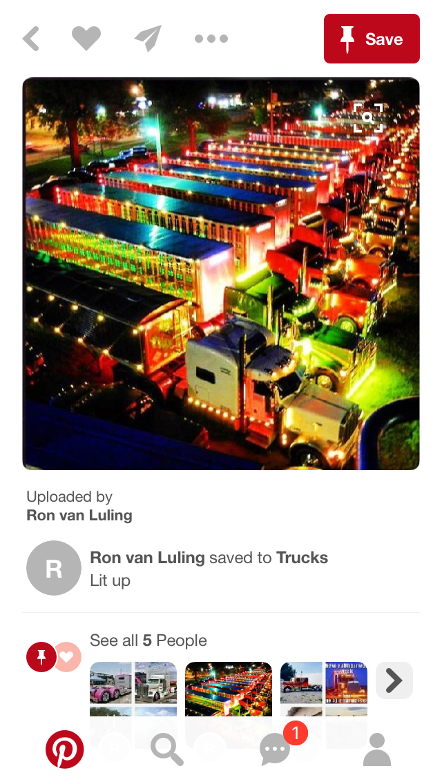

    And all through the night, not a single hood was taken off.....
    Great picture!
