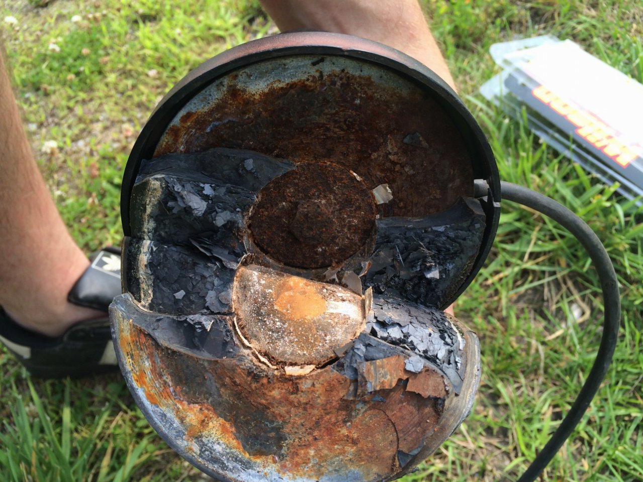

    My Wilson 5000 magnet mount just broke the mag came apart and now my swr is ####.

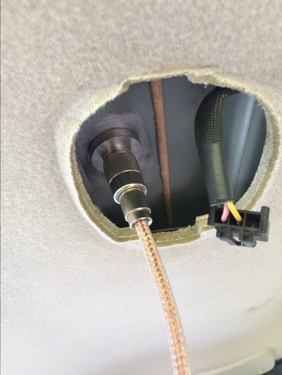

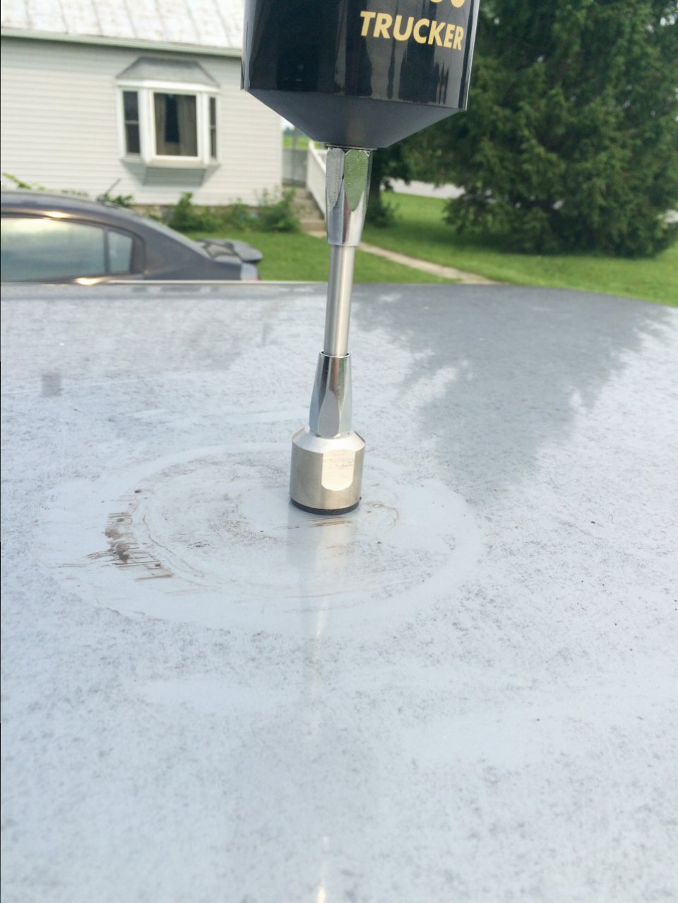

    Ok well I got the HD stud and drilled a hole and got my antenna up but now my swr is way over 3:1 what is going on?
    Did I put the mount on my roof wrong?

    They don't sell the mag mount anywhere near me, I wanted to hard mount this Wilson 5000 trucker but my swr is way way way over 3 no matter what I do.
    Could the antenna be defective? No shops are open till tomorrow and I need it now

    I know the mount is to small but that's not the issue right now.

    Is that the coil from the mag mount? If so, you have added length with the shaft below it. The whip will have to be adjusted accordingly.

    No that's the trucker 5000 that I just bought to replace the mag 5000
