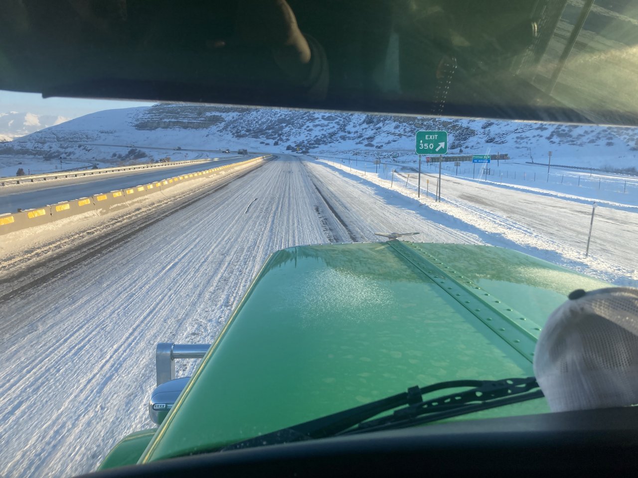

  9. Short Fuse EOD
    Short Fuse EOD Road Train Member
    2,791
    8,762
    Jul 29, 2015
    Midwest
