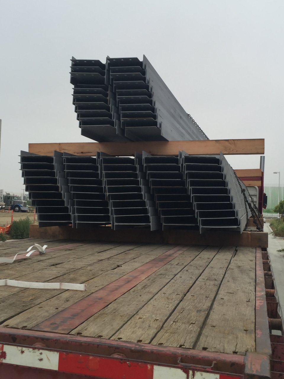

    Wow, lucky young man right there! I bet next time he utilizes a bulkhead and a couple chokers.

    Shoulda had a few chokers with rubber mudflaps between the steel and chain for some bite.
    There's few things as slippery as steel on steel.

    No securement is ever enough if the forces involved are greater than the strength of the system (the WLL of devices is only rated for 0.8g of forwards deceleration force). A deck driver should never slam on the brakes. It's asking for things to go wrong.
    Would the old "piece of dunnage" under the front and back lifts, tilting them towards the centre trick work/help? This is why I prefer dressed lumber.

    If you are hauling something that you know to be difficult, wouldn't you make sure that the strength of the system, exceeds the forces involved?
