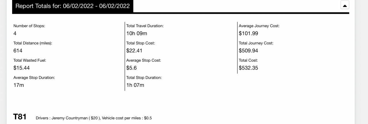

    This is my Verizon Reveal ELD system.
    You can pull daily reports on any vehicle in your fleet.

  8. bonder45
    bonder45 Road Train Member
    1,803
    5,452
    Oct 2, 2011
    Williston, ND
    Here is a rough report.
  9. Dave_in_AZ
    60,897
    426,608
    83 cents a mile seems good for the kind of work you do.
  10. bonder45
    1,803
    5,452
    Oct 2, 2011
    Williston, ND
    That's just a guess, I think the average that truck does OTR is ( or at least what I budget for ) is $1.05 / mile just in fuel.
    Dave_in_AZ Thanks this.
