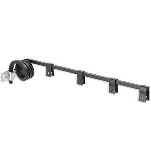

    Hello there. My boss is yelling at me because I keep losing mudflaps on the tractor. The brackets are the plain old bent square steel type. These brackets keep snapping. I HAVE yanked a flap off on a curb, and I know that backing into things is bad. However, when I'm bobtail on the freeway and bouncy af, I get to watch my mudflaps snap off at the bracket in my mirrors every few weeks. But boss wont believe me. He's telling me that can't happen. He says something I'm doing is breaking them. Is there anywhere on the web with an illustration of a cheap bent square steel mudflap bracket snapping, or any record of it? I need to work with him to get better/spring loaded/something brackets. ... Help?

    Like these?
    Whatever they look like they shouldn't be coming off just driving down the road. Either they're not being installed properly or you're damaging them somehow.
    Anything breaking off your vehicle while driving is a hazard for other motorists. Fix the problem before something bad happens.

    This (snapping) is common with these, especially when bobtailing frequently
    Best thing to do is replace with this type below. These won't snap as easily on rough roads as those above that don't have the flex curl. Regardless, make sure you use the properly applied cotter pin to keep them from jumping out of the holder

    Toss that #### and put some spring loaded ones on.
