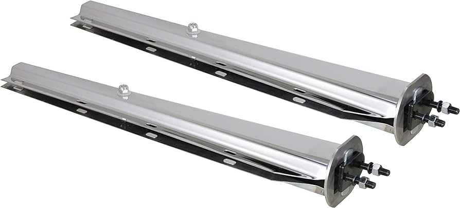

  7. gekko1323
    gekko1323 Road Train Member
    1,668
    2,785
    Jul 14, 2018
    Henderson, NV
    The ones I took off were similar to this, albeit with all the lights and crap.
    Rideandrepair Thanks this.

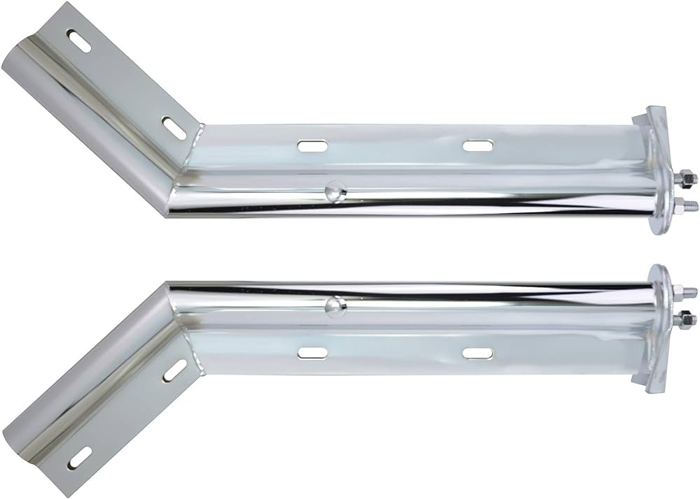

  8. AModelCat
    29,759
    165,353
    Just about anywhere I'd imagine. Used to get them from the dealer but I see you can buy them on Amazon for about $150 but they'll probably be cheap chrome and not stainless.
    I like the angled ones.
