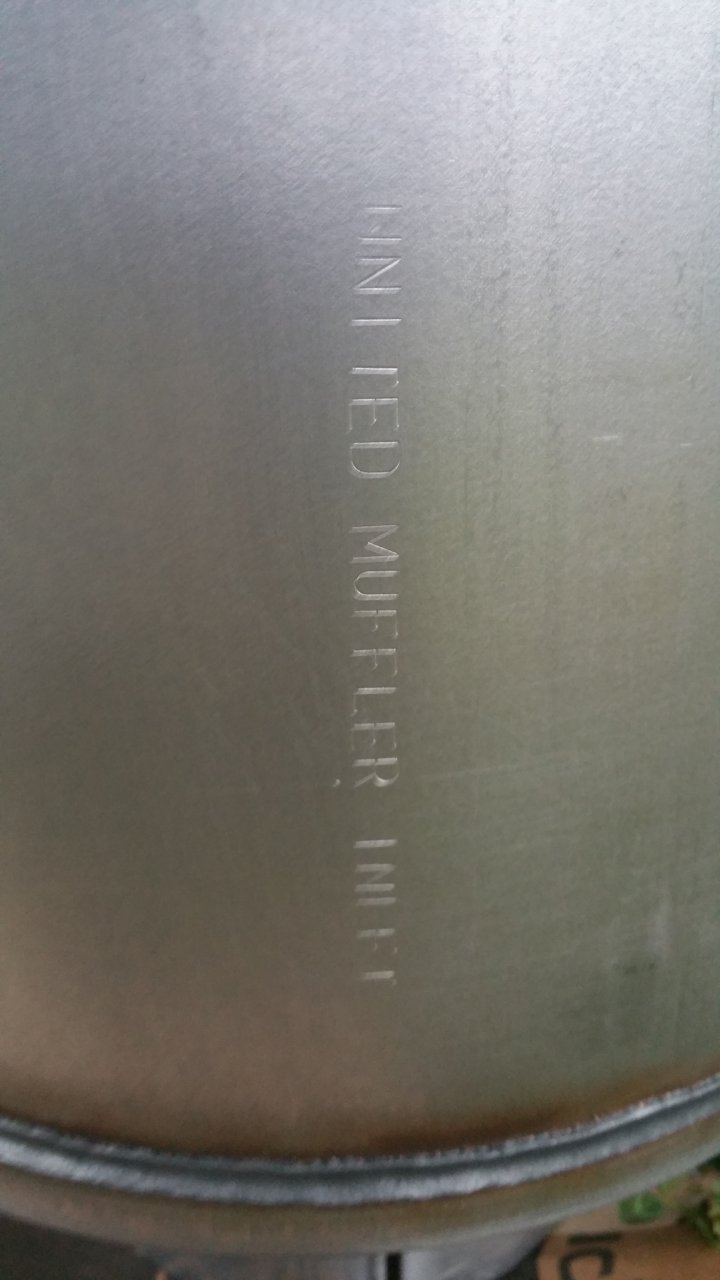

    No part number on it. Just a custom built muffler and not aluminized.
