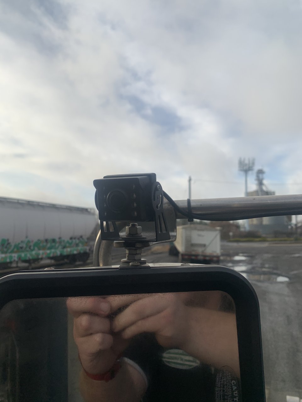

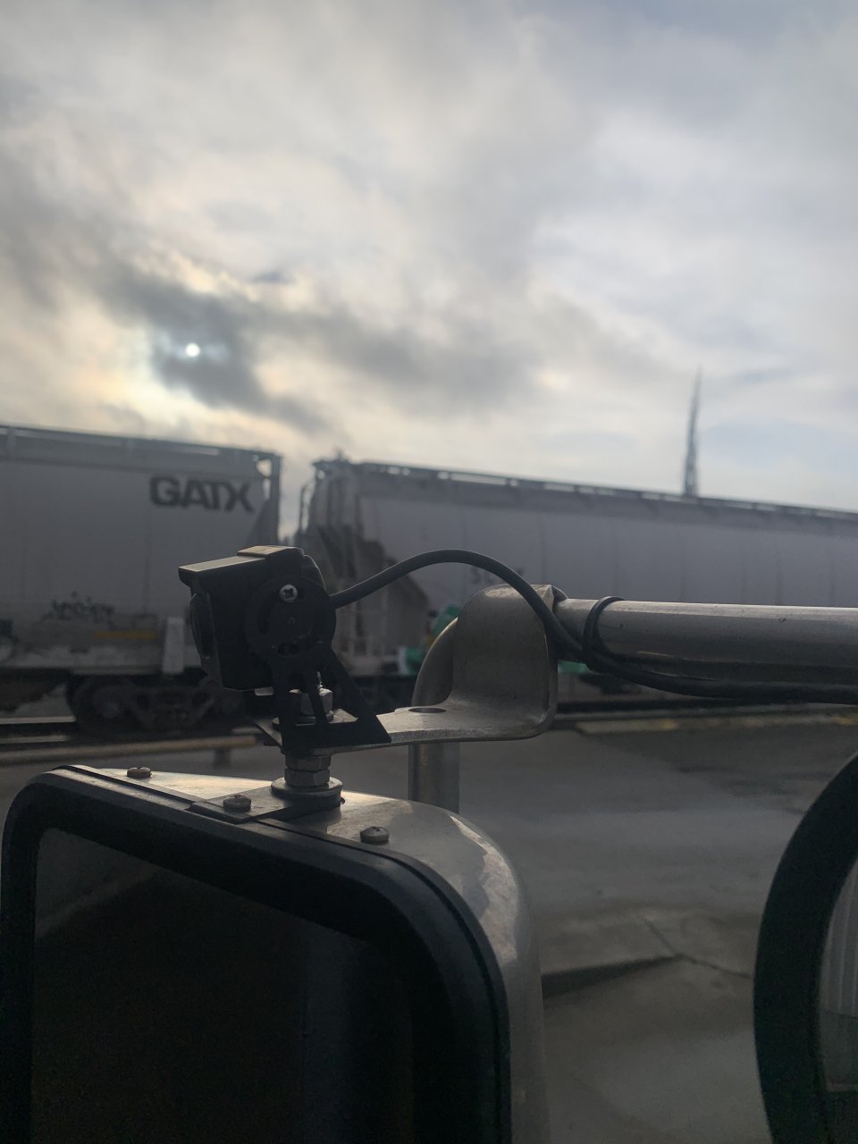

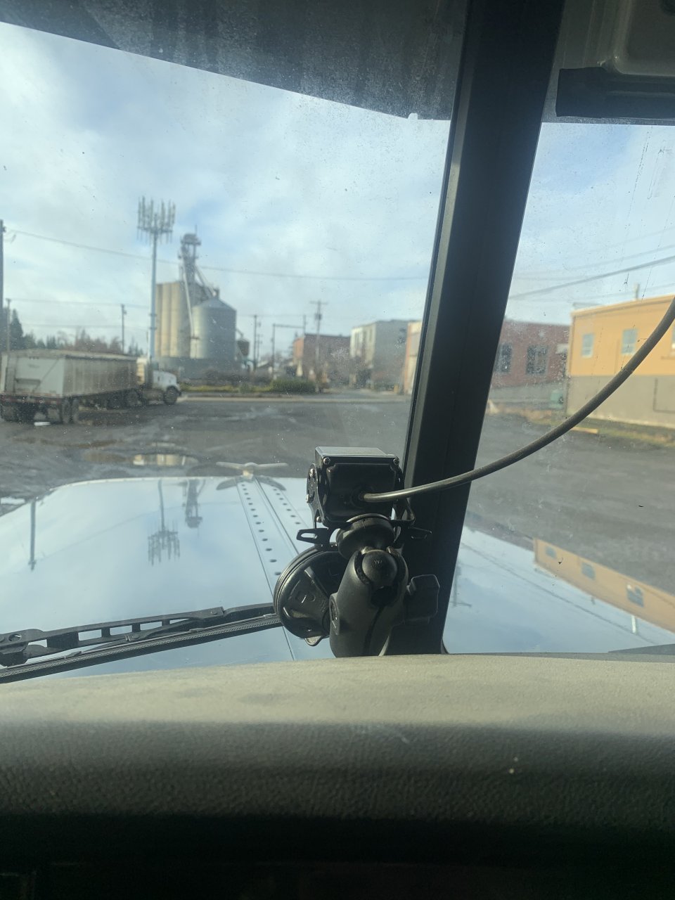

  9. Roberts450
    Roberts450 Road Train Member
    2,237
    3,638
    Feb 6, 2016
    This is how mine are mounted. I had the install done at their shop and they wanted to use the ram mounts too, Im like umm no there’s a better way. Only thing Im regretting now is making the decision to have them run the wires through the mirror arms. The right side camera isn’t working right now because the cable has shorted out or something. In order to run the wires through the arm they had to cut and splice them, they did send me a new cable under warranty but just havent gotten around to replacing it yet as Im not sure which way I want go run into the cab just yet. I’ll end up ether notching the mirror arm bracket for the cable, or through a grommet in the cab above the door by the rear mirror brace. I mounted the forward cam with a view as close to my view as possible so that it dosent show a car that I couldn’t see if that makes sense.

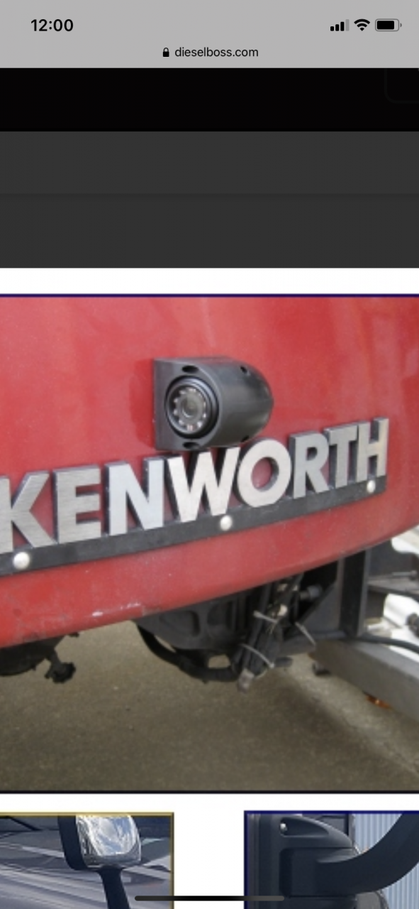

  10. Oscar the KW
    Oscar the KW Going Tarpless
    12,247
    28,120
    May 19, 2011
    This is from his site. I don’t see why you couldn’t mount one of these to a FB antenna bracket. If you have mirrors like @Roberts450 how he has his mounted looks good too.
  11. Wespipes
    Wespipes Road Train Member
    1,037
    1,816
    Jul 14, 2019
    This looks good. I'm going to mount them just like this
