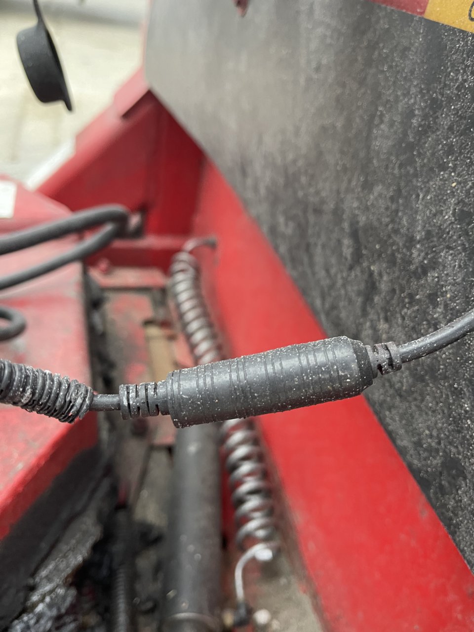

    @AM 561 If you cover the connections with heat shrink it 6E92BCD9-0D84-4596-92A2-039D1E750FFD.jpeg E42E79F6-E6CC-4B5A-B557-A23FD7BEA381.jpeg seems to help keep the corrosion from happening as quickly inside the connections. The bottom pic is the cable I found on Amazon that has the removable rubber sleeve that works as well as the heat shrink.

    And a little dielectric grease inside the plug

    Inside the plug dielectric grease did not work on mine because the video feed would not go thru with the grease. After I cleaned the grease off the inside I used a very small amount on the threads to help keep moisture out before I put the heat shrink on. Since then I have had no issues with those plugs.
