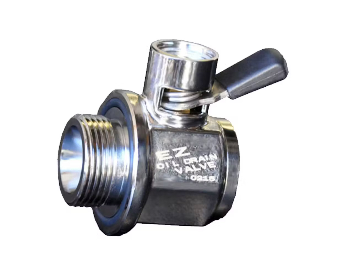

  8. Diesel Dave
    9,661
    32,714
    Jan 20, 2010
    Hesperia, Ca.
    Before I installed the EZ drain, I use to put Teflon tape on the plug and reinstall.

  10. Diesel Dave
    9,661
    32,714
    Jan 20, 2010
    Hesperia, Ca.
    The EZ drain should work for you next time, you said in an earlier post that you can’t drain the oil all at once, with the EZ drain, you shut off, get another bucket and continue. Just saying…….

  11. Brandonpdx
    Brandonpdx Road Train Member
    4,716
    4,840
    Dec 27, 2007
    Elkhart, IN
