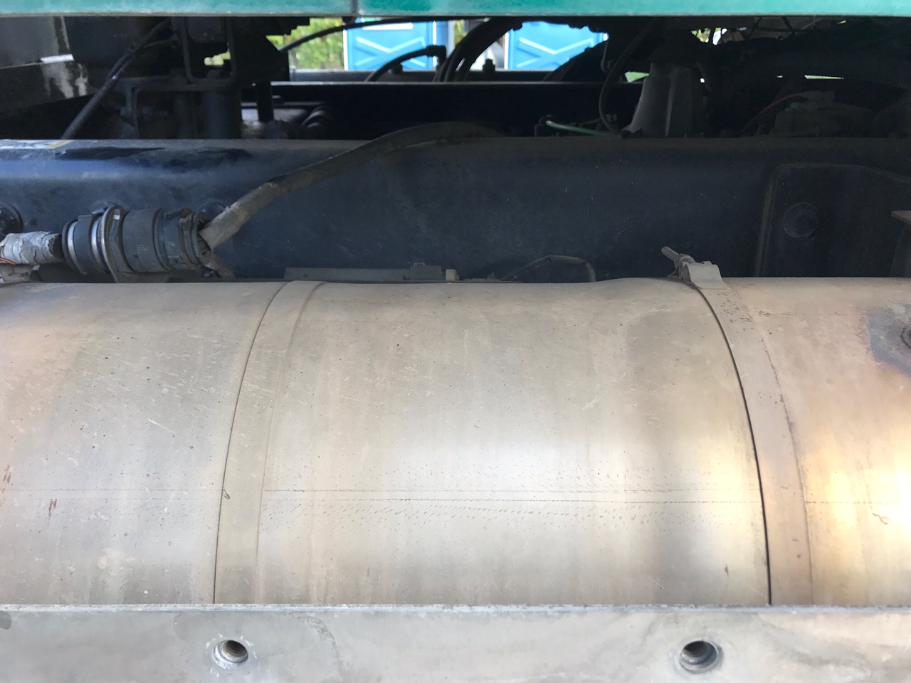

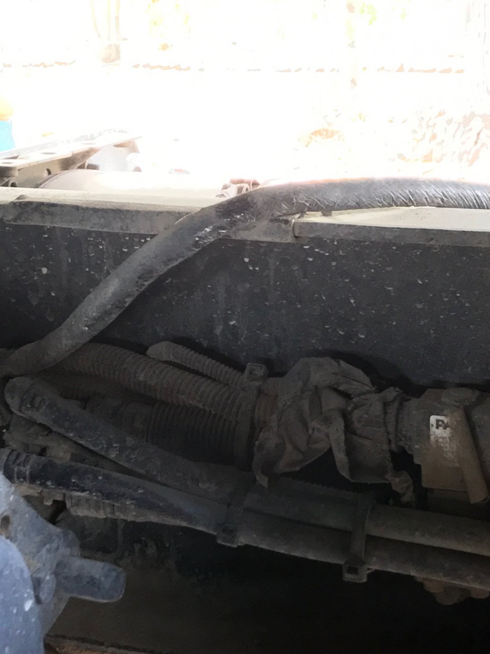

    Where exactly was grounding issue? can you post picture? also was it an epa10 or epa 13 engine. i have a "2013" 384 w/ a epa10 engine and having airpurge code and delta pressure. Thanks

    We sold those trucks so I don't have a picture. Just look under the passenger door, you should see the wiring harness laying on the frame as its routed back to the front of the truck. It rubs on the frame right there and causes electrical issues.

    It could be the delta pressure sensor just needs to be replaced. Not sure how hard it is on a paccar, but its simple on a detroit. Unplug it, remove it, get new one and put back in.

    Is this the wires that go to aftertreatment filters? This is a Day Cab 2013 384 w/mx epa10
    Don't judge, its an truck that hauls an end-dump....dirty.
