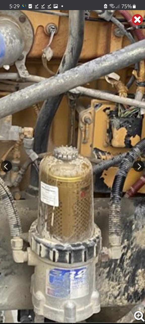

    Should I change this to a cat housing or just change out the 90° fittings?
    Do these style of fuel filter restrict the flow of fuel?
